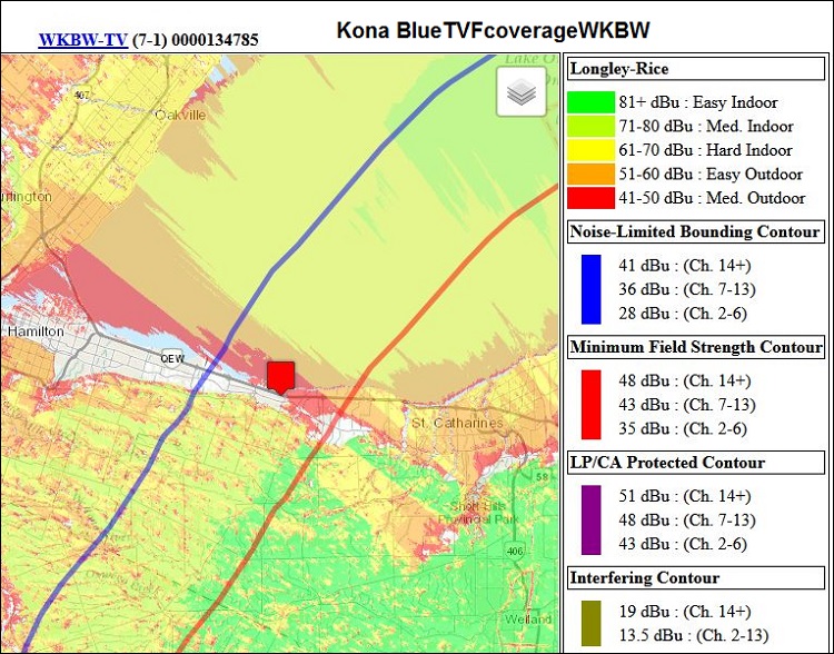

.....I was surprised to see the extra hill a few miles west of the escarpment.
Here is a terrain profile using different software:
You are on the edge of a dead zone (no color):

Old 16-Mar-2021, 9:38 PM   #15
Kona Blue
Join Date: Mar 2014
Posts: 14
The dead zone makes sense since I am in the shadow of the escarpment. I am down near the lake so anyone in town closer to the escarpment would be completely out of luck. I tried one of those stick-on flat cheap Amazon antennas behind the downstairs TV and surprisingly it can pick up WUTV with some freezing so maybe a proper antenna in the attic would get me one or two channels from Buffallo. Will have to give that a try.
