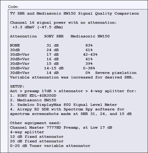

Code:
TV SNR and Mediasonic HW150 Signal Quality Comparison
Channel 16 signal power with no attenuation:
 +3.3 dBmV (-47.5 dBm)
Attenuation   SONY SNR   Mediasonic HW150
NONE           31 dB           83%
30dB           24 dB           61%
30dB+Var       17 dB          42-43%
30dB+Var       16 dB           41%
30dB+Var       15 dB           39%
30dB+Var      14-15 dB        0-38%
30dB+Var       14 dB           0%  Severe pixelation
Variable attenuation was increased for desired SNR.
SETUP:
Ant > preamp 17dB > attenuator > 4-way splitter for:
1. SONY KDL-40R350D
2. Mediasonic HW150
3. Sadelco DisplayMax 800 Signal Level Meter

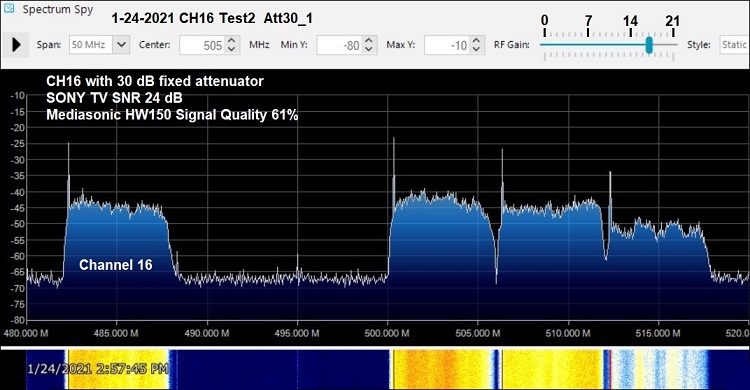

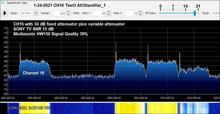

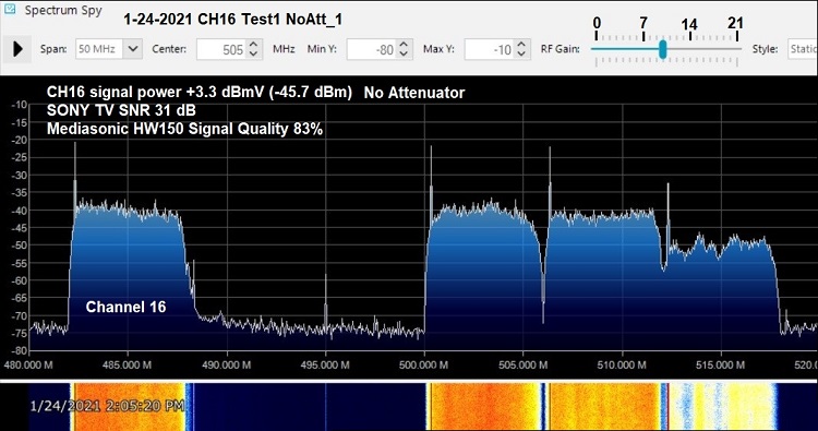

4. Airspy R2 SDR with Spectrum Spy software for
spectrum screenshots made at SNR 31, 24, and 15 dB
Other equipment used:
Channel Master 7777HD Preamp, at Low 17 dB
4-way splitter
10 dB fixed attenuator
20 dB fixed attenuator
0-20 dB Toner variable attenuator
CODE data above saved as image:
Here are the screenshots of the CH16 signal at SNR 31, 24, and 15 dB:

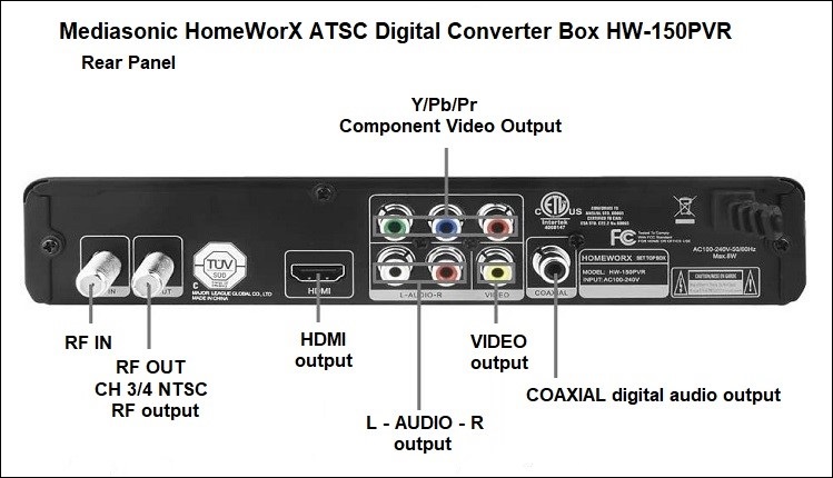

The Mediasonic HW-150 has a built-in power supply and outputs for HDMI, Component, and Composite. (Composite is also known as CVBS for Composite Video Baseband Signal) The less expensive HW-130 has a separate wall-wart power supply and outputs for HDMI and Composite; no Component output.
