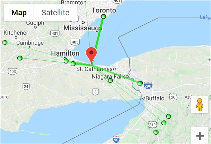

Being new to this and living in Grimsby Ontario I am going to assume a two-panel antenna would be best, given Toronto is at 15 degrees and Buffalo is at 111 degrees (if I read the map right) with a distance of 35 miles for both. The attic is huge and easy to navigate so size does not matter. Any recommendations on a reasonably priced antenna that would work in my situation would be appreciated. Thanks

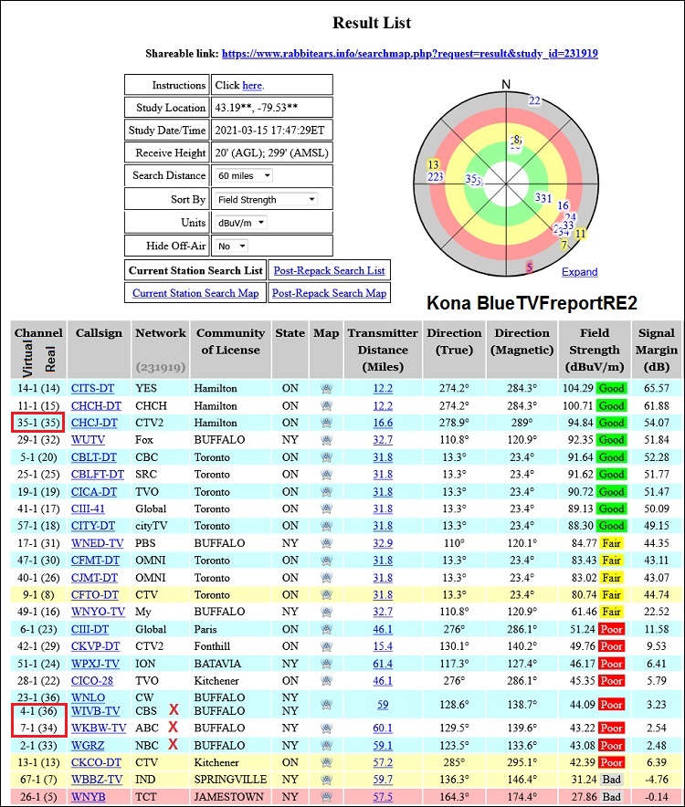

Realistically, there are only two Buffalo stations that will work for you with an attic antenna, WUTV and WNED. Also, CTV (CFTO) is on VHF channel 8.
An eight bay UHF aimed in two directions may work and may not work, as multi path increases with antennas aimed in two directions. That is made even more likely with an antenna in the attic. You are a better candidate for two antennas each with their own down lead; a VHF/UHF for Canadian stations, and a second UHF only for Buffalo. You would use an external tuner for the stations in Grand Island. Due to adjacent channel issues reception of the Buffalo stations located in Colden and Boston, south of Buffalo, would be impossible unless you install an outdoor antenna with sufficient rejection of channel 35 from Hamilton.

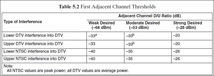

In your case attempting to combine the two antennas simply won’t work. This is because channel 35 from Hamilton is roughly 50 dB stronger than channels 34 and 36 from Buffalo. Digital tv on adjacent channels works only if the signal strength difference on adjacent channels is less than 30 dB. The 91XG has about 28 dB rejection of channel 35 when the antenna is aimed at Buffalo. That would make Hamilton 22 dB stronger than WNLO/WIVB and WKBW.
If any attempt is made to combine antennas, Hamilton’s channel 35 will prevent reception of channels 34 and 36 from Buffalo and would be a waste of time.
There is no other way to make Hamilton weak enough to receive NBC and ABC from Buffalo other than using a specific dedicated antenna properly aimed for Buffalo.

Tower Guy is correct. CBS, ABC, and NBC are very weak and blocked by terrain.
https://forum.tvfool.com/attachment....3&d=1615849187
https://www.rabbitears.info/searchma...tudy_id=231919
https://forum.tvfool.com/attachment....4&d=1615849227
https://forum.tvfool.com/attachment....5&d=1615849250
ATSC Recommended Practice:
Receiver Performance Guidelines
Document A/74:2010, 7 April 2010
RECEIVER PERFORMANCE GUIDELINES
5.4.2 Adjacent Channel Rejection
The receiver should meet or exceed the thresholds given in Table 5.2 for rejection of first adjacent-channel interference at the desired signal levels shown above the columns therein.

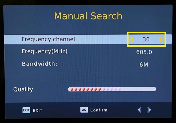

The HW-150 will allow you to add a channel after a scan using the Manual Search window in the menu. This keeps you from having to rescan over and over again when hunting for a missing channel.
https://forum.tvfool.com/attachment....7&d=1615853232
