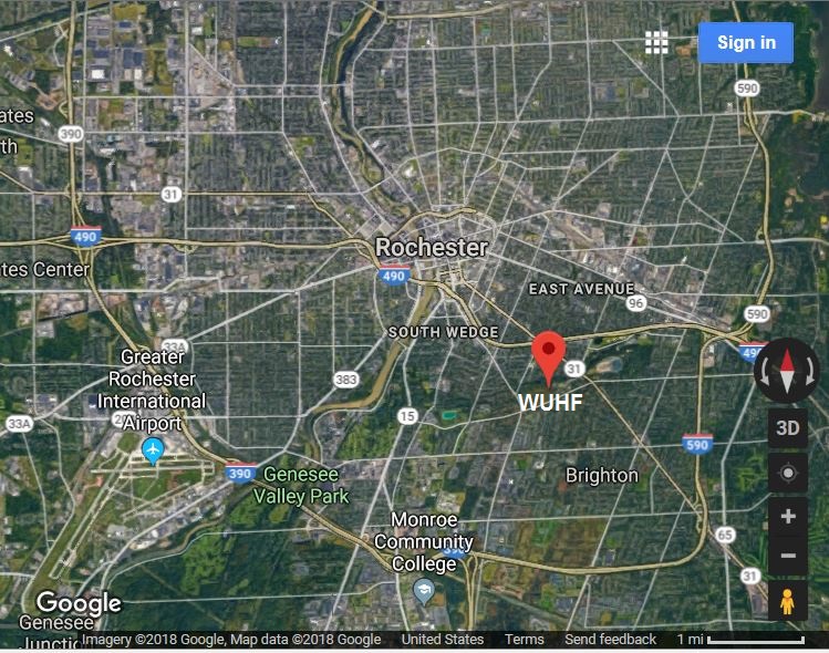

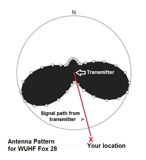

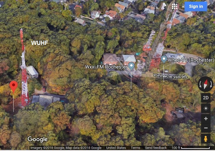

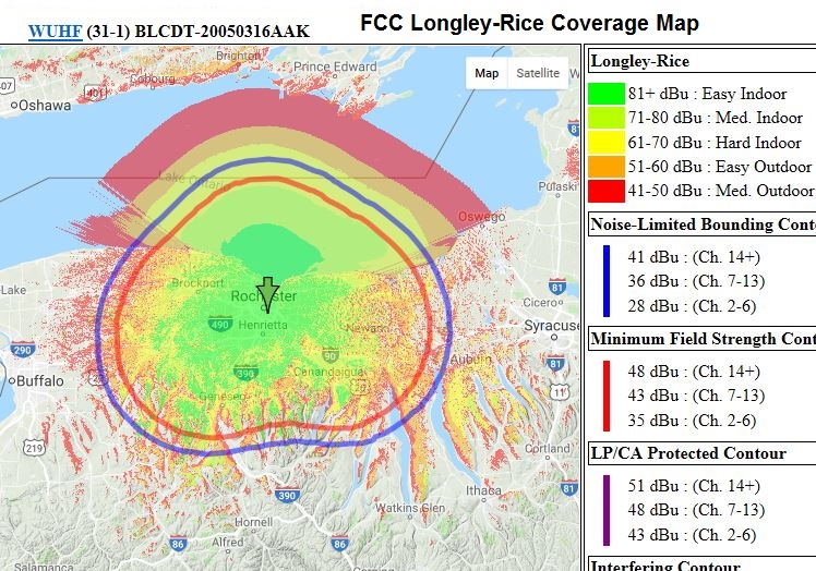

Originally Posted by Dagwood View Post
Not quite getting that last image. Where is Rochester and/or the transmitter?
The transmitter is at the center of the pattern:

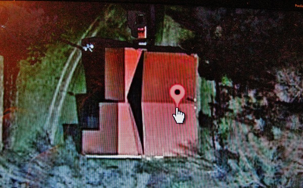

If you don't have a GPS, you can use the TVFool Interactive map browser.
Once you have found your home, you can move the teardrop indicator to the location of the antenna by drag-and-drop. As you move the teardrop, the coordinates below the map will follow.
Move the white fist to the base of the teardrop until the index finger points to the base of the teardrop.
Left click the mouse and hold it down.
Move the indicator to the antenna location and release the left click.
The coordinates of the antenna will be below the map; copy and paste them.

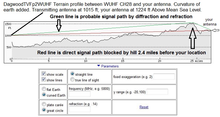

Thank you for the additional information by PM. This profile shows that the WUHF and other Rochester signals have a hard time getting to your antenna because of the hill that blocks a direct signal path.

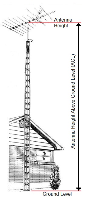

Put it into the tv Fool report and see what you
Wined up with and set the ANTENNA on a 45/90AGL/DgAGL?
For that one channel i have looked into the tv Fool have
Playing with it by antennas higth by adding ft and pled
With the AGO frum,0,,to a 45DG,AGL.,too,a90 DGAGL?
What a BIG!! Improvement like a 1000+% so know!!
RAIBBIT.what does AGL,stand for does it stand for?DG,AGL?
On the tv Fool report? And you should move the ANTENNA too the
Left about 3.1/2 ft over TOO the left look at the picture of the tree's over the roof and
Where the ANTENNA is sitting know it's pointing right into the tree.?look ??

AGL=Above Ground Level
This is for AGL:
This is for DG,AGL = Degrees Angle:

The FCC uses AGL to describe the height of the transmit antenna on a TV tower.
