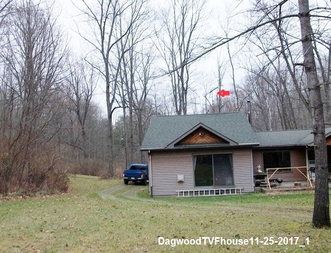

What it looks like around here . . .
Here is a view from the south, looking north towards Rochester where all the transmitters are (pik is about due north, Rochester is a bit to the west). Red arrow shows antenna which if you look carefully, you can see it is rotated a bit west:
Looking north from the roof:
Looking south:
Looking north again. As you can see, not much changes from year to year. The hill shown in the FCC diagram (that you posted in September in this thread) is about 2-3 miles north of me, nothing but woods between me and the hill.
This all looks like a Wineguard, and makes sense as everything else is too:

Thanks for the excellent photos. That looks like the Winegard HD7697P or 7698P.

The trees and the hill certainly could be the major problems.
That might be a good idea, as long as you understand that it could be something else like a bad connection in the balun/combiner.
The trees certainly could be the major problem.
Trees: I've been here for 35 years, nothing has changed. Big trees get old and die, young trees replace them -- although a photo taken 35 years ago wouldn't look much different than these photos.
Last fall was no different than the previous 34 falls, but this fall is different. Just taking the knowns and thinking logically, I would conclude that it isn't the terrain/flora (which probably hasn't changed much since the ice age) there is something not quite right with the man-made antenna system.
That might be a good idea, as long as you understand that it could be something else like a bad connection in the CB-8269
cartridge housing (balun/combiner). The CB-8269 is an odd design. The forks make contact with the wires from the UHF and VHF sections in a way that doesn't look 100% reliable to me. There is a replacement available:
https://www.amazon.com/Winegard-CB-8.../dp/B003H2G5ZM
https://www.solidsignal.com/pview.asp?p=cb-8269
http://www.winegarddirect.com/viewit...(CB8269)&post=

your photos, with the trees that tall and the hill, it is surprising that
you receive anything at all. None of that explains why you are having
the recent issues and the outages. Your Winegard antenna is a very
good one but the weakest link in the design is that CB-8269 housing.

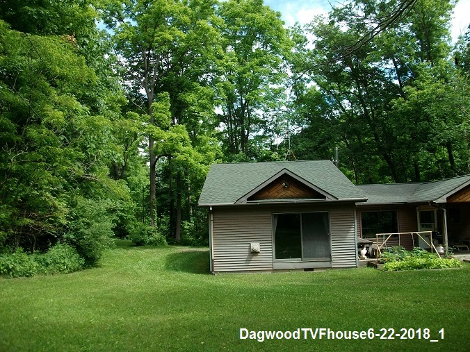

Thanks for your help and comments, Joe! Hopefully the problems were just with channel 8's signal not being up to par, as you suggested.
I don't know what I would do without you knowledgeable guys here on this website. I probably would have gone up on the roof and jumped off on purpose, lol. There is no cable available here, and I don't think there is enough open area for satellite either, so OTA is all I have.
EDIT: Just for giggles, this is what it looks like around here today as contrasted to the December pictures that I posted earlier in the thread:

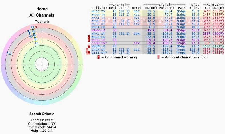

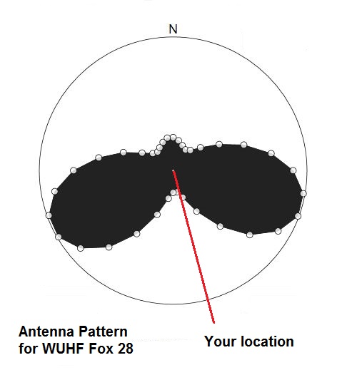

Thanks for the report and the photo in the summer.
Even if your antenna system is in perfect condition, I think you will continue to have problems with the trees.
Fox is your weakest signal, and their transmitting antenna has a directional pattern that doesn't send much power south; it favors east and west of Rochester.
After the FCC Repack of UHF channels, WHEC will stay on 10:
https://www.rabbitears.info/market.p...&callsign=WHEC
WHAM will move from 13 to channel 9, so you will need to rescan:
https://www.rabbitears.info/market.p...&callsign=WHAM
WXXI will move from 16 to 22:
https://www.rabbitears.info/market.p...&callsign=WXXI
WROC from 45 to 21:
https://www.rabbitears.info/market.p...&callsign=WROC
WUHF will stay on 28.
https://www.rabbitears.info/market.p...&callsign=WUHF
Transition Phase 4: Testing Begins: 6/22/2019 Phase Ends: 8/2/2019
The only things I can think of to improve your reception would be to move your antenna higher to a location that doesn't have trees directly in front of it, or mount a smaller UHF only antenna on a tower to improve the reception of your weaker channels and combine it with your present antenna for VHF using a UVSJ UHF/VHF combiner.
In retrospect, the issue with channel 8, WROC may have been
at their end. Perhaps they were running at lower power than
normal or their antenna may have needed some "tuning" to
perform at 100%.
Yes, it is possible that WROC CBS, real channel 45, virtual channel 8.1, is running at reduced power for the safety of the tower workers mounting the new channel 21 antenna.
Yup, it never comes in during the summer, even 20-30 years ago when it was analog. Digital actually helped it; it stays on longer in the spring and comes back sooner in the fall. I gain maybe a month or more on each end.
Not quite getting that last image. Where is Rochester and/or the transmitter?
