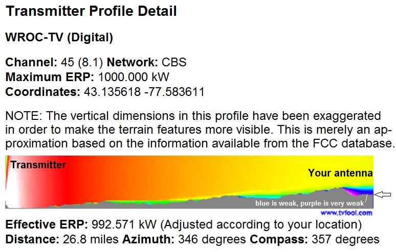

NBC, ABC, PBS always come in fine. CBS is normally fine, but if the antenna isn't aimed exactly it can be dicey, depending on the weather.
I only get FOX from around September/October until April/May.
That description exactly matches your signal report. NBC, ABC, and PBS are your strongest signals, and CBS is listed just a little weaker than PBS. Fox is a lot weaker than CBS.
CBS sends 992 kW out of 1000 kW ERP in your direction. If you click on the CBS callsign in your report, this is what you will see:

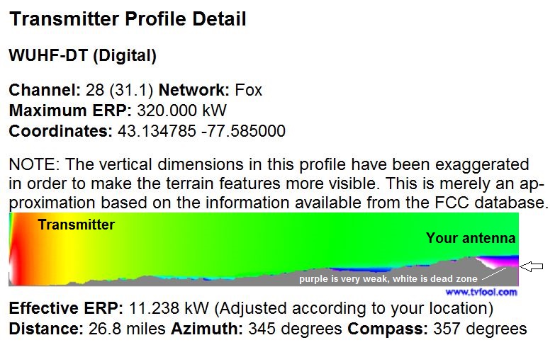

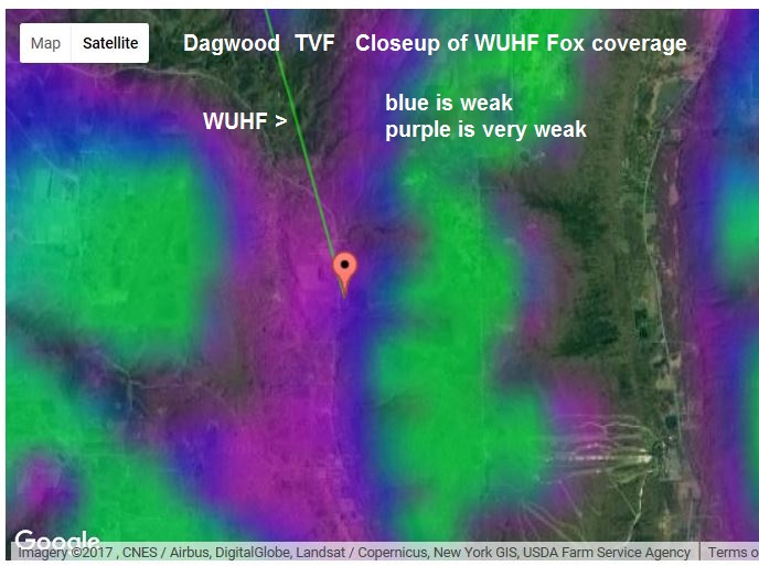

Fox is much weaker because it has a very directional transmitting antenna that sends only 11 kW out of 320 kW ERP.
http://www.tvfool.com/?option=com_wr...dALLTV%26n%3d5
http://forum.tvfool.com/attachment.p...1&d=1505610948
I only get FOX from around September/October until April/May. It is like this every year, and was the same even before 2009 when it was analog. I assume it has something to do with the atmospheric changes as the seasons change. It does not correspond with the leaves being on or off the trees.
What you assume is correct; the seasonal change does make a difference. In the warmer weather, the Fox signal is not able to bend down to your location by refraction because the density of the air changes in warm weather.

I hadn't seen those pages, interesting -- I assume my house is way over on the right behind that big hill, heh.

With digital TV, they suddenly drop out at a certain point as they get weaker. This point is called the "Digital Cliff."
http://forum.tvfool.com/attachment.p...7&d=1465958114
The sudden dropout is caused by the FEC (Forward Error Correction system). The FEC is designed to correct the digital signal errors to maintain a good quality picture. As the digital signal gets weaker, there are more and more digital errors. The FEC has a limit to how many errors it can correct. Once that limit is exceeded, the FEC gives up, and the signal drops out.

I haven't had any more incidents of everything going completely out, but I am having reception problems.
As previously noted in this thread, I do not get FOX in the summertime but it always starts coming in around the end of September and lasts until maybe early May. This fall it didn't come in. So I've been on the roof numerous times rotating the antenna slightly either way. I have trees and a phone pole for reference points.
As time went on it started coming in, probably because the weather got colder, not from me adjusting the antenna.
So here we are in late November and I'm still having problems, not only with FOX but with CBS (my two weakest channels). I can't tell you how many times I've been on the roof (twice just today) and I'm getting tired of it. When winter sets in and there is snow on the roof, I will not go up there (too old for that stuff).
There has to be something wrong because I've never had problems like this, this late in the fall, since I installed everything new in 2011.

Sorry you are having more trouble. Those two channels are very weak; it doesn't take much to knock them out.
You told us about your power inserter, but you didn't tell us what model of preamp you have.
You also didn't tell us what antenna you have. If you don't know the make and model, can you show us a photo of your antenna?
One thing might be different now: The trees might be thicker and taller now, so even if the leaves have fallen, the signals might be having a harder time now getting through.

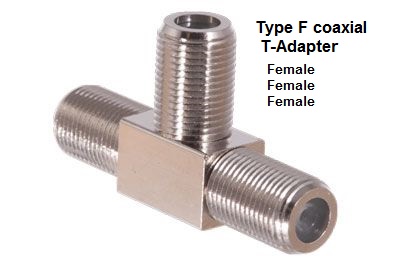

You have checked the voltage coming out of the power inserter, but you haven't checked the voltage to the preamp at the upper end of the coax that connects to the preamp.
And you haven't checked the voltage to the preamp at the upper end of the coax when it is connected to the preamp. This is harder, because when you check the voltage to the preamp near the preamp when it is connected, you need access to the center conductor. I use a T-adapter for that:
http://forum.tvfool.com/attachment.p...8&d=1511635684
This is for an RCA preamp, but the method is the same:
http://forum.tvfool.com/attachment.p...9&d=1511636090
http://forum.tvfool.com/attachment.p...0&d=1511639045
