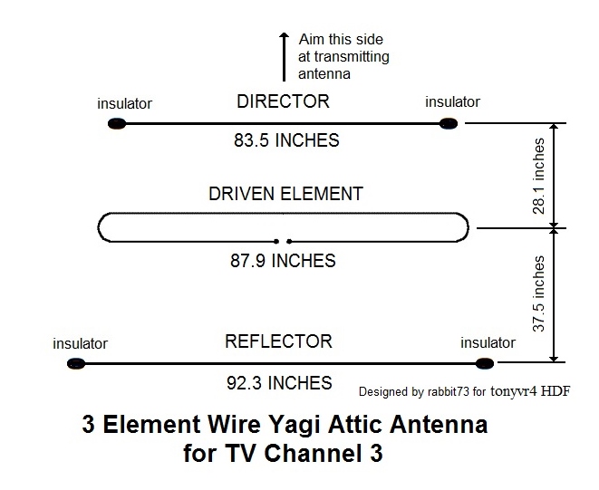

To convert the dipole antenna into a 3 element beam for more gain, add a reflector and a director:
Wire Reflector, 92.3 inches,
Wire Director, 83.5 inches,
dipole to reflector spacing is 37.49 inches
dipole to director spacing is 28.12 inches
