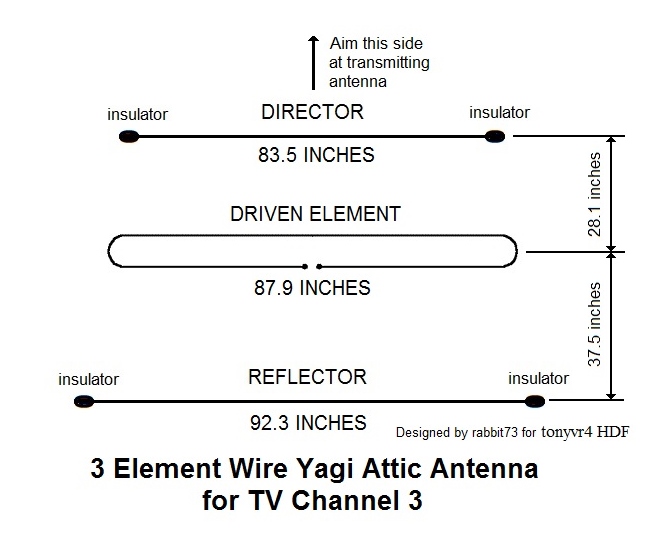

rabbit73 11-Feb-2017 9:23 PM
1 Attachment(s)
To convert the dipole antenna into a 3 element beam for more gain, add a reflector and a director:
Wire Reflector, 92.3 inches,
Wire Director, 83.5 inches,
dipole to reflector spacing is 37.49 inches
dipole to director spacing is 28.12 inches
http://forum.tvfool.com/attachment.p...1&d=1486848071

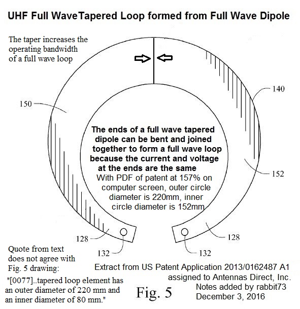

The most interesting fullwave loop antenna is the element used in Antennas Direct UHF antennas. Think of it as a fullwave dipole that has fat ends to increase the bandwidth, the way that whiskers increase the bandwidth in the bowtie antenna. Then, imagine that the ends are bent up to meet each other and join. This creates a tapered loop. Don't make one to sell, Antennas Direct holds the patent.
http://forum.tvfool.com/attachment.p...1&d=1488153777
