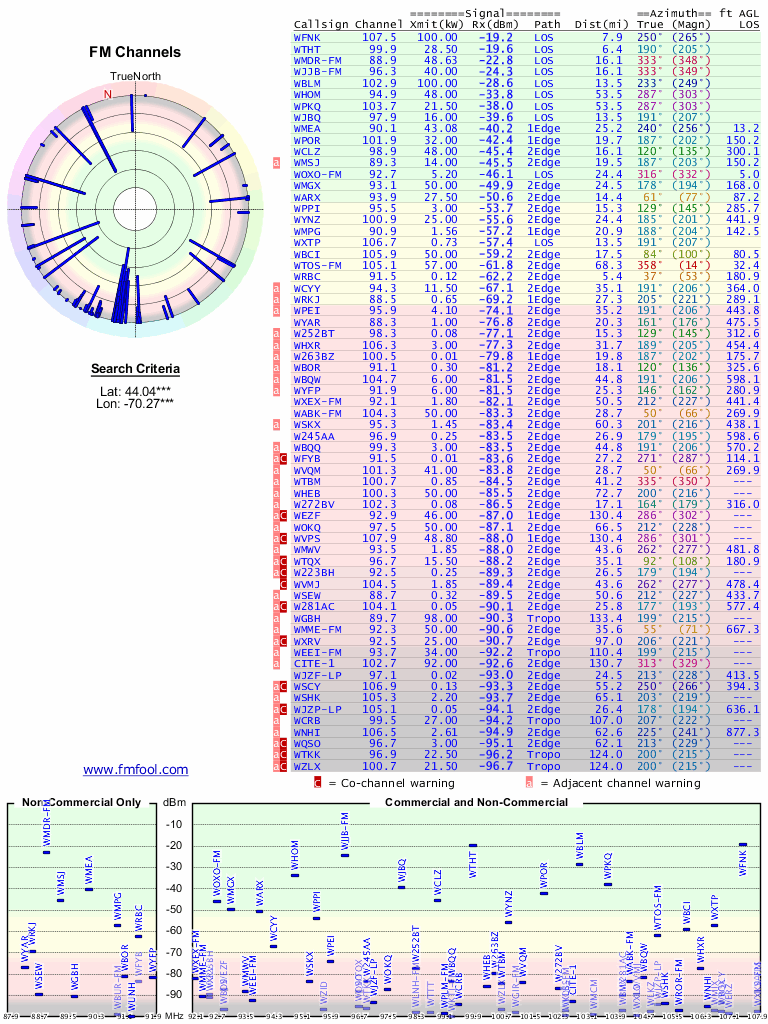

Originally Posted by Ellie View Post
Only problem is, still no PBS channel 10.1 (VHF)... Silly question, but -- could FOX channel signal be overriding PBS channel (see analysis chart in original post)?
I'd doubt that Fox is the issue. You have two strong FM stations that could be problematic.
When strong FM stations are an issue there needs to be an FM trap between the antenna and the preamp. This limits your choices of antennas to unamplified and if you must use an amplifier, get an FM trap to install between the antenna and an external preamp.
http://www.antennasdirect.com/store/....html?mobile=N

Electron, thanks for your suggestions; will purchase length of coax & coupler on next shopping trip and give that a try... One questions though. You mention "amplifier control full on". My antenna has no amplifier "control", just a thin cord (like a headphone cord) that plugs into base of unit and other end plugs into wall plug... A tiny light on base unit lets me know that the "amplifier" is powered on.
Tower Guy, sorry don't understand about "inserting an FM trap" between antenna & preamp... Antenna has one coax cable permanently attached to base then a separate tiny cord that plugs into back of unit (looks like a headphone jack) with wall plug on other end. Where would I insert a trap(?)
Worst case, can anyone suggest another antenna to try? One that can be amplified and a "trap" inserted if necessary...
