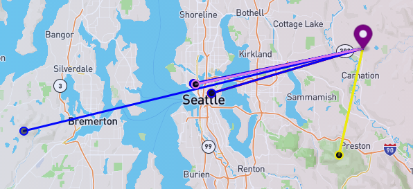

So I live in a pretty poor reception area with the stations color coded in red, blue and violet, the few that are yellow are don't care, go figure eh?
According to the tv's signal quality indicator all the stations are marginal.

Currently I have a 40 ft mast with a cell antenna and a original cm-4228 bowtie pointed west connected to 100 ft lmr-400 that feeds into a cm-3414 4 way powered splitter.
I am thinking about adding (stacking) a RadioShack U-120 uhf and a VHF antenna (model unknown at this point) and adding cm-7777 preamp with the hopes of getting more signal
I do have several trees about 100ft west of the antenna that should probably be removed, and a hill 4 miles away that basically blocks line of sight

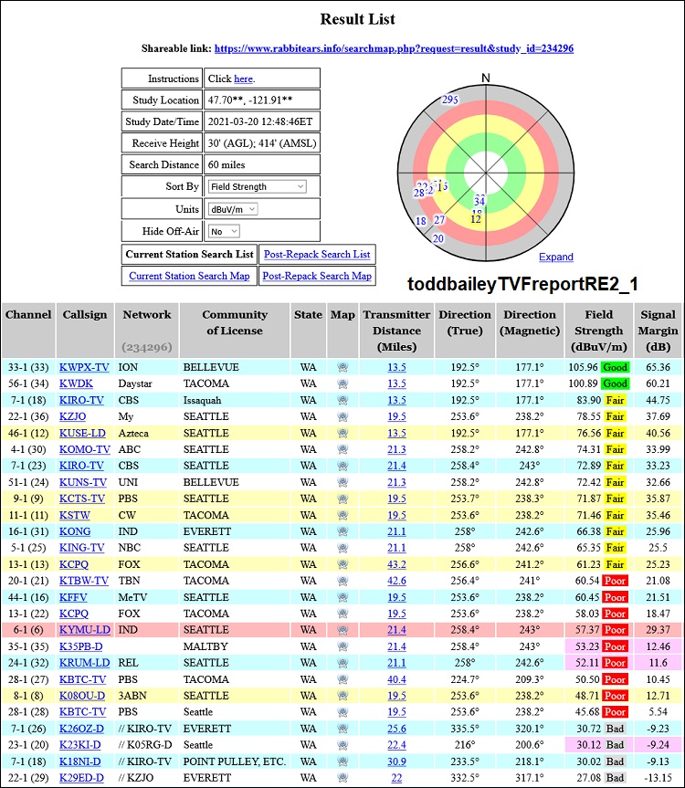

His rabbitears.info signal report:
https://www.rabbitears.info/searchma...tudy_id=234296
