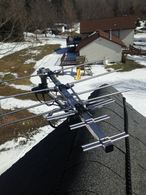

I have attached pictures of my roof setup. If there are any other pictures needed, let me know and I will post them.

I see a coil of coax at the antenna.
Connect the coiled coax to the matching transformer.
Disconnect and bypass the preamp unit at the antenna.
Disconnect and bypass the power injector.
Disconnect and bypass the power supply.
Bypass the splitter , connect one Tv.
Reception now??

I see 2 splitters. Remove them.
The input of one of the splitters has what looks like some type of double coupler. Remove it.
Remove ->ALL<-of the cable Tv hardware that is connected with the antenna system.
Remove ->All<- of the preamp , remove the preamp , remove the power injector , remove the power supply.
For 2 Tv's connected use a simple common 2 way splitter.
For 3 Tv's connected use a simple common 3 way splitter.
For 4 Tv's connected use a simple common 4 way splitter.
For 5 Tv's connected use a simple common 6 way splitter.

If you don't see everything you know you should, stop... figure out why, fix it, then move on to testing more of the system. Any trouble shooting done after this point is futile and confusing unless you resolve the problems already present. Did you fine tune the location and aim of the antenna? How many pieces of cable were between the antenna and TV? How many feet of cable was between the antenna and TV? Now would be a good time to try a new coax, directly from the antenna to the test TV. It would also help us a great deal to know what signal you thought you should get, but did not. Did you do a new scan for channels? Call sign and real channel number is the ideal way to identify the signal.
Yes, take the antenna, preamp and TV to a location with weak signals and try it there. The signal power shown on your TVFR strongly argues against the use of any preamp, especially one prone to overloading. The signals in the air at your location are too powerful to test that type preamp with.
BUT....
It does not matter whether it's defective or overloading... it's not needed or even useful. It's adding to your problems. Get your money back, get rid of it. It's stopping you from focusing on obtaining a clean signal from the antenna at the end of a reasonable length of coax.
With the preamp and power injector totally removed from the system, it sounds like there are still two or more pieces of coax between the antenna and the basement distribution point where you split. Is that because there are splices or because there are additional splitters or other accessories? I'm not as convinced as you are that the cables and connectors are free of trouble. Every connection is a point that can go open due to corrosion, wear due to repeated assembly/disassembly, water intrusion, etc.
- When I say I don't see everything that I should I mean I don't have all the channels that I had when I used the cheap indoor antenna with the built in preamp in the attic and the injector located just before my splitter. I still get like 22 channels when going direct from the antenna to a TV in the basement. Though some of them are duplicates.
- The antenna is aimed at 277 degrees.
- Between antenna and TV in the basement there is one solid length of cable connected directly into the antenna and the TV. It is approximately 50 ft of cable
- I already ran a new coaxial directly from the antenna to a test tv. I just dropped a line off my roof and through a window. I got the exact same results.
- I did a new scan. I was getting 5 or 6 more channels. I will try to get exact call sign information for you.
Lets just assume that I ditch the preamp. How do I solve my problem with the issues with the signal dropping to the approximate 7 channels from the local towers after the signal is split?
Right now I have a http://www.monoprice.com/products/pr...seq=1&format=2
antenna hooked up inside my living room directly to my main TV with the power injector connected and I am getting more channels than I did with my roof antenna directly connected by a single coax to a single TV in my basement. I don't understand that at all.
Without the preamp, there is only one length of quad shield rg6 running from the antenna, into my attic, to the basement and into the splitter.
Thanks again for your patience and help.

Connect a NEW as in --> NEW loooong coax to the matching transformer that is connected to the antenna.
Run the NEW loooong coax -->directly<-- through a open door or window and connect 1 Tv.
NO amplifier , NO power injector , NO power supply , NO couplers , NO splitters , NO nothing.
It is the , Antenna , the matching transformer , the coax , the Tv.
Scan for Digital Broadcast Tv channels , Not cable channels.
Reception Now??
If not then install a NEW matching transformer.
And Yes I know you installed a new matching transformer , install a NEW one anyway.
Reception Now??
  Reply With Quote
Please don't presume that the preamplifier in the Monoprice antenna is helping you. The signal levels shown on your TVFR indicate you should be seeing many stations with an unamplified antenna. Your 'tests' continue to make me question the integrity of the ANT-751, and/or the matching transformer.
Good call.
It's not hard to over-tighten the connector on some of the matching transformers currently available. If the connector twists, the internal connections in the transformer can break. If that happens, you can be left with the equivalent of a short paper clip for an antenna. In the presence of strong signals, that may be enough 'antenna' to do a mediocre job.
On a separate note, in the photo of your splitters, do I see an attenuator between the coax and input to the 4-way splitter?

I did that already with a NEW cable. I did a broadcast scan. I do get reception, but about 6 channels less than I do with the indoor monoprice amp connected directly to the TV.
I am going to buy another matching transformer to see if it works any better.
Good call.
If you mean the red thing in the middle, yeah I guess that is a attenuator. I have since removed that and nothing has changed with my signal through the splitter.
As I said in my previous post, I will try a new transformer and not over tighten.
Should I still be getting stations over 50 mi away with no preamp?
GroundUrMast, I really appreciate your continued help and for not making me feel like an idiot through this process. I do try to do my homework with this stuff. Mostly for me its all self taught thought I am getting beyond my level of knowledge with this particular issue. So sincerely, thank you for your help and patience.
That depends on the signal levels in the air, at your antenna's location. Can you give us the call sign and real channel number of the station(s) you're referring to? Based on the path profiles shown in your TVFR, you are on the side of a hill with line of sight toward Syracuse, you should have no trouble with signal levels at that distance. Any signal on your report with a NM value of 40 dB or greater is powerful enough to drive 100' of RG-6 (6 dB loss), an 8-way splitter (12 dB loss) and another 100' of RG-6... (40 dB NM - 24 dB distribution losses still leaves you a net NM at the TV of 16 dB.) And that assumes no antenna gain. http://forum.tvfool.com/showthread.php?t=109
