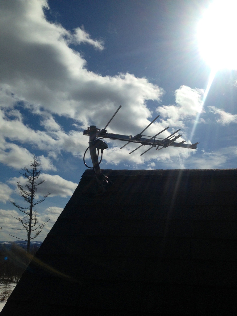

First, here is the link to my signal analysis:
http://www.tvfool.com/?option=com_wr...1ddae813d84d07
I recently canceled cable and decided to buy an antenna. I live on a hill and about 2 miles from our closest towers.
My house has 5 coaxial feeds all run (home run) to a main splitter in the basement next to my service box. This is where the old cable line fed in. I ran all the cable myself and used quad shield RG-6 cable. I currently only have 2 televisions hooked up in the house.
Originally I bought a cheap indoor/outdoor antenna with a built in preamp and set it up in the attic. I ran a coaxial from the attic, through a interior wall (in a gray conduit) and then into the basement and inputted into the splitter. I connected the preamp power injector in the basement, just before the splitter. The total cable run b/w the splitter and antenna is probably around 50', maybe less.
This setup initially worked great, I got the local tower channels and also channels 50+ miles away (to the west). After a while I started randomly having problems with the signal completely dropping and I'd have to go to the attic and adjust the antenna to get it working again.
I decided to buy a roof mounted antenna. After reading positive reviews I bought the RCA751 and the TVPRAMP1R. I used the same setup only ran my coaxial that was in the attic through my ridge vent to the roof. I mounted the antenna and preamp on the supplied J-Mount. I hooked up the power injector to the same location in the basement.
After I got everything set up I scanned the channels and got NOTHING, no signal at all, not even from the towers 2 miles away.
I did some research and found that there have been some issues with the matching transformer that came with the antenna so I purchased a new RCA matching transformer with gold leads and installed that today. Still nothing. It will not find one channel.
At this point I'm at a loss. I've done plenty of research on this and am fairly certain that I have everything hooked up correctly. I cannot figure out what is wrong.
I have attached pictures of my roof setup. If there are any other pictures needed, let me know and I will post them.
My only other thought is that there has to be an issue with the coaxial wire but it was previously working so I'm not sure. I figured even with some issues I'd still at least get the towers 2 miles away, but yet not one channel comes in.
Please, I need some advice on my next step to resolve this. I will provide any further information needed.
Thank you all in advance

What direction are you aiming? 270ish? Not that it much matters for those that are so close to you.
First thing I'd do is try the most simple install, removing all other factors. If you can, run a single drop from the antenna to a single TV and scan for channels. Make sure you have the TV set to OTA & not cable. From there tweak until you get the best reception, then change out to the permanent cable run. See how that works for the same TV, then connect the splitter, and if the split is too much loss for reliable reception for all TV's, then connect the preamp.

I see a coil of coax at the antenna.
Connect the coiled coax to the matching transformer.
Disconnect and bypass the preamp unit at the antenna.

Forget the preamp. You are far too close to several towers and almost any pre-amp, but especially the one you have, will overload causing a "no reception" situation. You don't need one in any event.
Yes, I agree completely.
Signals with a noise margin (NM) in the air of 30 dB and greater should be able to drive a passive 8-way splitter with no amplification and still leave power to drive long coax runs. The signal from WFXV is far more powerful, enough to easily overload most preamplifiers.
You started your trouble shooting well. You've proven you have a usable signal at the antenna and at the end of a moderate length of coax. What you have not proven is the integrity of the coax from the roof to the basement.
I strongly agree with the suggestion of removing both the preamp and power injector. Then, connect a TV to the coax in the basement. You should have no trouble getting enough signal power there. If you don't get reliable reception on a single set in the basement, it suggests you have a bad coax or connector (or both).
I won't dispute that you see a change in the symptoms when you add the amp into the mix... I'm suggesting that there is an underlying problem that needs to be found and fixed... once you do that, the amplifier will not be needed or even helpful.

I did hook a TV directly to the line going into the basement with no preamp attached. I got most of the stations very well, but not everything I know I could and should get.
If you don't see everything you know you should, stop... figure out why, fix it, then move on to testing more of the system. Any trouble shooting done after this point is futile and confusing unless you resolve the problems already present. Did you fine tune the location and aim of the antenna? How many pieces of cable were between the antenna and TV? How many feet of cable was between the antenna and TV? Now would be a good time to try a new coax, directly from the antenna to the test TV. It would also help us a great deal to know what signal you thought you should get, but did not. Did you do a new scan for channels? Call sign and real channel number is the ideal way to identify the signal.
I would like to know is there any way to actually test this preamp to be certain whether it is working properly or not?
Yes, take the antenna, preamp and TV to a location with weak signals and try it there. The signal power shown on your TVFR strongly argues against the use of any preamp, especially one prone to overloading. The signals in the air at your location are too powerful to test that type preamp with.
BUT....
As soon as I hooked the preamp and plugged in the injector through the same connection I got nothing at all...
...Really I am trying to figure out if this preamp is a defective unit. If that's the case, I can at least start by returning it. Should I really be losing ALL signals when the injector is plugged in even with running it through the splitter?
It does not matter whether it's defective or overloading... it's not needed or even useful. It's adding to your problems. Get your money back, get rid of it. It's stopping you from focusing on obtaining a clean signal from the antenna at the end of a reasonable length of coax.
With the preamp and power injector totally removed from the system, it sounds like there are still two or more pieces of coax between the antenna and the basement distribution point where you split. Is that because there are splices or because there are additional splitters or other accessories? I'm not as convinced as you are that the cables and connectors are free of trouble. Every connection is a point that can go open due to corrosion, wear due to repeated assembly/disassembly, water intrusion, etc.
BUT....
- When I say I don't see everything that I should I mean I don't have all the channels that I had when I used the cheap indoor antenna with the built in preamp in the attic and the injector located just before my splitter. I still get like 22 channels when going direct from the antenna to a TV in the basement. Though some of them are duplicates.
- The antenna is aimed at 277 degrees.
- Between antenna and TV in the basement there is one solid length of cable connected directly into the antenna and the TV. It is approximately 50 ft of cable
- I already ran a new coaxial directly from the antenna to a test tv. I just dropped a line off my roof and through a window. I got the exact same results.
- I did a new scan. I was getting 5 or 6 more channels. I will try to get exact call sign information for you.
Lets just assume that I ditch the preamp. How do I solve my problem with the issues with the signal dropping to the approximate 7 channels from the local towers after the signal is split?
Right now I have a http://www.monoprice.com/products/pr...seq=1&format=2
antenna hooked up inside my living room directly to my main TV with the power injector connected and I am getting more channels than I did with my roof antenna directly connected by a single coax to a single TV in my basement. I don't understand that at all.
Without the preamp, there is only one length of quad shield rg6 running from the antenna, into my attic, to the basement and into the splitter.
Thanks again for your patience and help.

Connect a NEW as in --> NEW loooong coax to the matching transformer that is connected to the antenna.
Run the NEW loooong coax -->directly<-- through a open door or window and connect 1 Tv.
NO amplifier , NO power injector , NO power supply , NO couplers , NO splitters , NO nothing.
It is the , Antenna , the matching transformer , the coax , the Tv.
Scan for Digital Broadcast Tv channels , Not cable channels.
Reception Now??
If not then install a NEW matching transformer.
And Yes I know you installed a new matching transformer , install a NEW one anyway.
Reception Now??
Please don't presume that the preamplifier in the Monoprice antenna is helping you. The signal levels shown on your TVFR indicate you should be seeing many stations with an unamplified antenna. Your 'tests' continue to make me question the integrity of the ANT-751, and/or the matching transformer.
Good call.
It's not hard to over-tighten the connector on some of the matching transformers currently available. If the connector twists, the internal connections in the transformer can break. If that happens, you can be left with the equivalent of a short paper clip for an antenna. In the presence of strong signals, that may be enough 'antenna' to do a mediocre job.
On a separate note, in the photo of your splitters, do I see an attenuator between the coax and input to the 4-way splitter?

I did that already with a NEW cable. I did a broadcast scan. I do get reception, but about 6 channels less than I do with the indoor monoprice amp connected directly to the TV.
I am going to buy another matching transformer to see if it works any better.
Good call.
If you mean the red thing in the middle, yeah I guess that is a attenuator. I have since removed that and nothing has changed with my signal through the splitter.
As I said in my previous post, I will try a new transformer and not over tighten.
Should I still be getting stations over 50 mi away with no preamp?
GroundUrMast, I really appreciate your continued help and for not making me feel like an idiot through this process. I do try to do my homework with this stuff. Mostly for me its all self taught thought I am getting beyond my level of knowledge with this particular issue. So sincerely, thank you for your help and patience.
That depends on the signal levels in the air, at your antenna's location. Can you give us the call sign and real channel number of the station(s) you're referring to? Based on the path profiles shown in your TVFR, you are on the side of a hill with line of sight toward Syracuse, you should have no trouble with signal levels at that distance. Any signal on your report with a NM value of 40 dB or greater is powerful enough to drive 100' of RG-6 (6 dB loss), an 8-way splitter (12 dB loss) and another 100' of RG-6... (40 dB NM - 24 dB distribution losses still leaves you a net NM at the TV of 16 dB.) And that assumes no antenna gain. http://forum.tvfool.com/showthread.php?t=109
