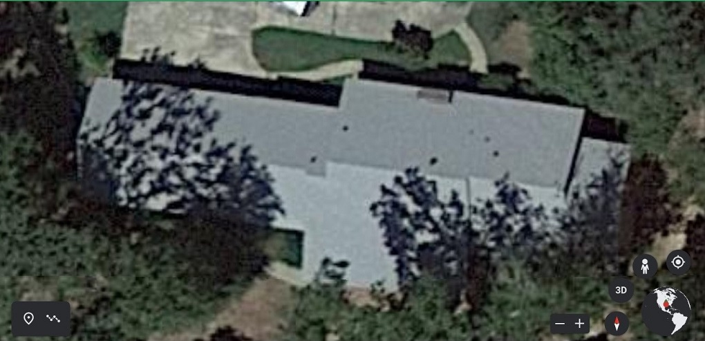

Channels 28, 34, and 21 were all weak. The antenna was sort of close to a tree at (1), so I've been wanting to move the antenna back about 50 feet to the other side of the house (2) like I tried to illustrate in the crappy picture below.
But now, my Roku TV is not showing ANY channels!
I've tried the following:
  • flip the RF filter
  • removed the RF filter
  • replace the coax with all new store bought
I've got one of these Coaxial Pocket Toner Continuity Testers:
https://www.amazon.com/dp/B096S5WM96
There are better ones, but this one beeps, telling me that my signal is getting through.
All I cannot test is the actual antenna on the roof or the antenna tuner inside the Roku.
What could have gone wrong? Is anyone familiar with something that sounds like this? I can't imagine what happened.

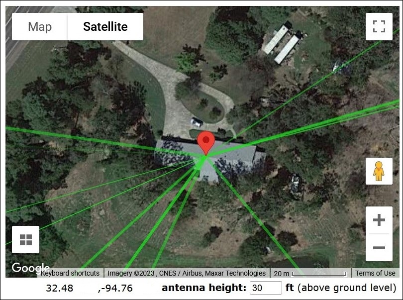

Here is an updated tvfool Signal Analysis:
We are now using reports from rabbitears.info because the TVFool database isn't up to date. You can do a report here:
https://rabbitears.info/searchmap.php
I did this report for what I think is your location:
https://rabbitears.info/searchmap.ph...tudy_id=969946
If the last two columns are pink, the channel is probably off the air.

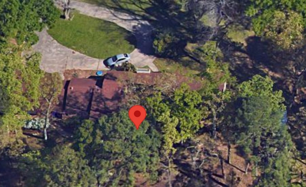

I don't see any antenna on his roof, but there are many trees. Maybe these photos were taken at the wrong time.
