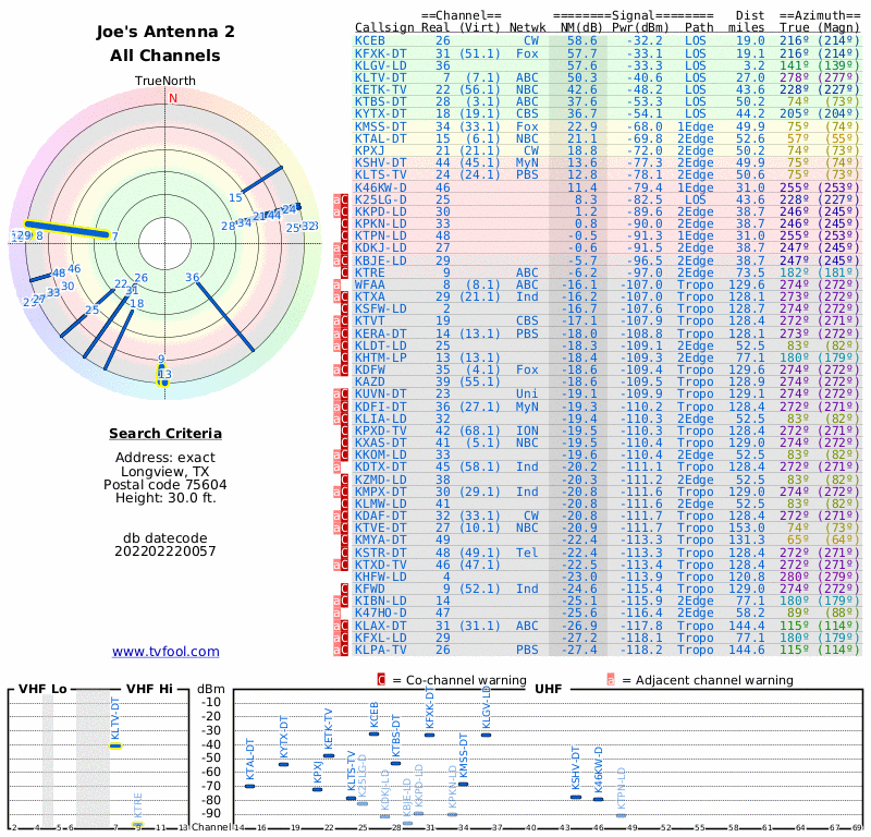

Here is an updated tvfool Signal Analysis:
https://www.tvfool.com/modeling/tmp/.../Radar-All.png
Channels 28, 34, and 21 were all weak. The antenna was sort of close to a tree at (1), so I've been wanting to move the antenna back about 50 feet to the other side of the house (2) like I tried to illustrate in the crappy picture below.
We are now using reports from rabbitears.info because the TVFool database isn't up to date. You can do a report here:
https://rabbitears.info/searchmap.php
I did this report for what I think is your location:
https://rabbitears.info/searchmap.ph...tudy_id=969946
https://forum.tvfool.com/attachment....2&d=1683245147
If the last two columns are pink, the channel is probably off the air.

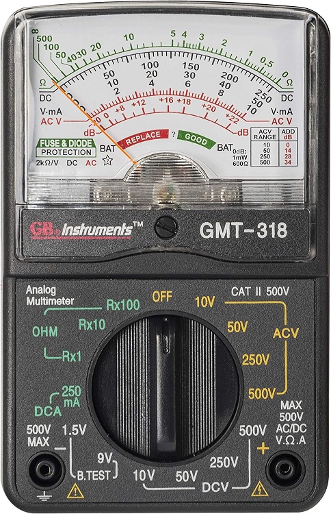

I would first suspect the new coax and connections. In order to test the coax, it has to be disconnected from the antenna and any other equipment. First you have to test for continuity of the center conductor and continuity in the shield. Next you have to check for a short between the center conductor and the shield. I use an ohmmeter to make those tests.
https://forum.tvfool.com/attachment....6&d=1683673766
