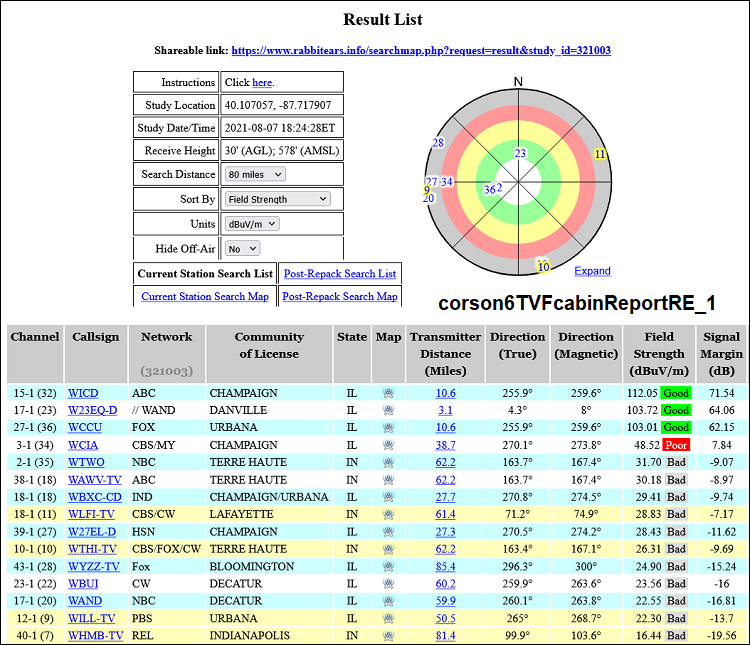

I did a report from rabbitears.info for your coordinates.
https://www.rabbitears.info/searchma...tudy_id=321003
The antenna for WCIA I suggest is the Solid Signal Xtreme Signal HDB91X.
Reception of WCIA will be difficult because it is much weaker than WICD and WCCU. If you add a preamp to make WCIA stronger, it will probably be overloaded by WICD and WCCU.
You can try the antenna without a preamp, but there might still be too much of a difference in signal strengths.
The optimum solution would be a custom single channel bandpass filter from Tin Lee Electronics for channel 34 WCIA, but it would be expensive.
You might have to settle for your news from WICD.
You are in the WCIA area of coverage, but your location is in a dead zone (no color):
and the WCIA signal is blocked by the curvature of the earth and a hill:
Here is another terrain profile using different software:

If you can live with WAND NBC, rather than WCIA, RF 23 carries
WAND translator W23EQ-D. The translator is almost due north
and would require either rotating an antenna toward the translator
or a separate antenna. No easy alternatives or solutions.....
That translator is only 3 miles away and likely to be easier to
receive than WCIA. Either way, Rabbit's antenna suggestion
is a good choice.
