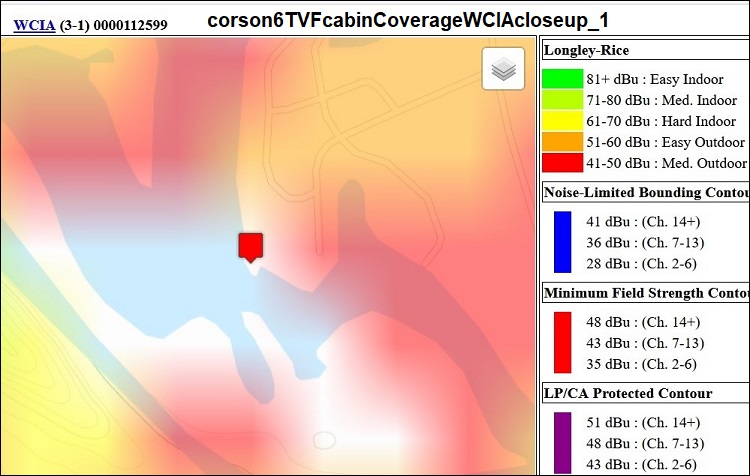

You are in the WCIA area of coverage, but your location is in a dead zone (no color):
https://forum.tvfool.com/attachment....1&d=1628380782

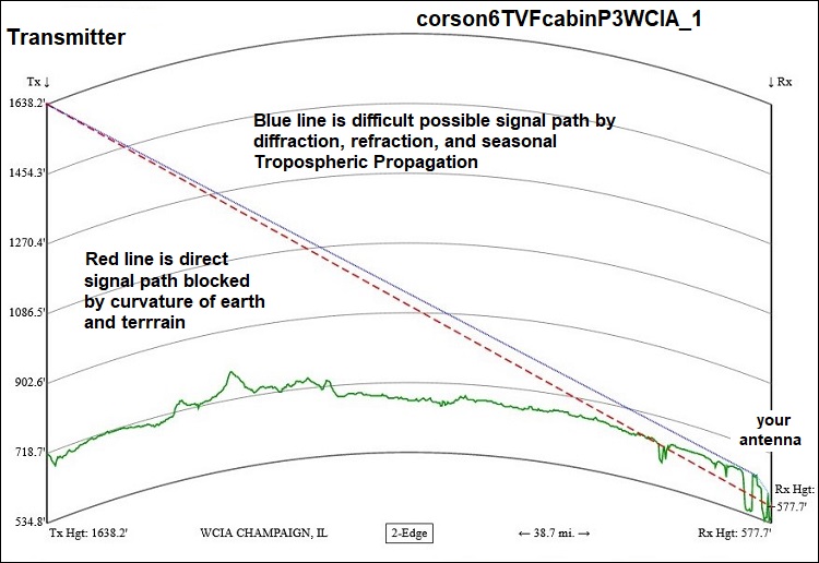

and the WCIA signal is blocked by the curvature of the earth and a hill:
https://forum.tvfool.com/attachment....2&d=1628380940

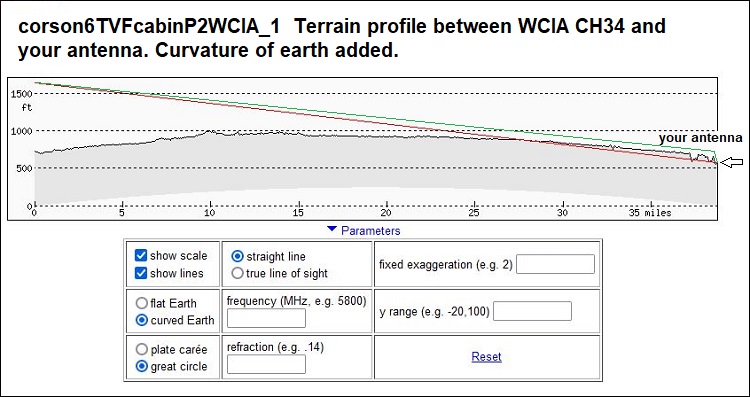

Here is another terrain profile using different software:
https://forum.tvfool.com/attachment....3&d=1628381160
