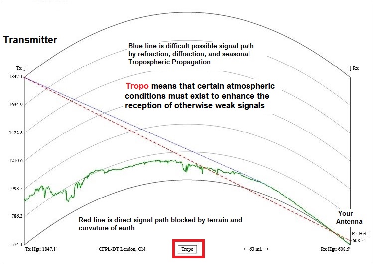

Receiving channel 10 from London will be difficult. You might need a separate VHF-High antenna for it if that channel is important.
The TVFool reports are not as accurate as they used to be; the database is out of date. I did a rabbitears.info signal report based on an estimate of your location:
https://www.rabbitears.info/searchma...tudy_id=270196
You can do your own report here (I use coordinates from Google maps):

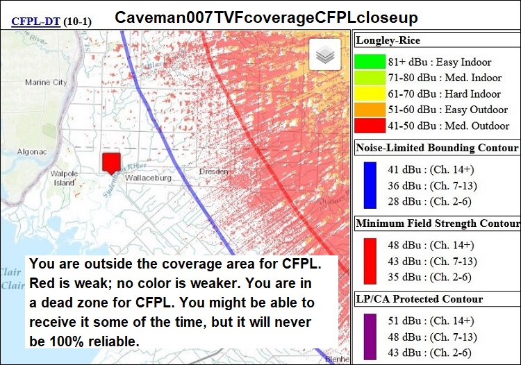

You are outside the area of coverage for CFPL:
and there is terrain blocking the direct signal:

I certainly don't want to confuse you, I'm just going by what the rabbit ears.info signal report says. The report is only a computer simulation. It tells me that your location is outside the area of coverage for CFPL on RF channel 10, the direct signal is blocked by terrain, and it is listed as a Bad quality Tropo signal.
This coverage map is by rabbitears.info:
Signal reports for weak signals can be wrong. I consider reception of CFPL difficult, but not impossible at your location. CFPL is about 55 dB weaker than your strongest channel.
CFPL is transmitted on a VHF-High channel. The antenna you are considering only has a dipole (the single horizontal element sticking out of each side) for that band; the loops are for UHF channels, not CFPL.
The report I did was based on my guess of your location in the NW section of Wallaceburg. Please do a rabbitears.info report for your location using coordinates. Also do a report for the other house you mentioned so that I can see the difference. A different location can have very different signal strengths. You can do the reports at this site:
