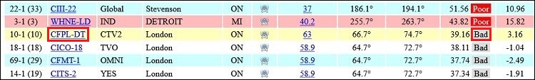

The TVFool reports are not as accurate as they used to be; the database is out of date. I did a rabbitears.info signal report based on an estimate of your location:
https://www.rabbitears.info/searchma...tudy_id=270196

You are outside the area of coverage for CFPL:
https://forum.tvfool.com/attachment....2&d=1622501145

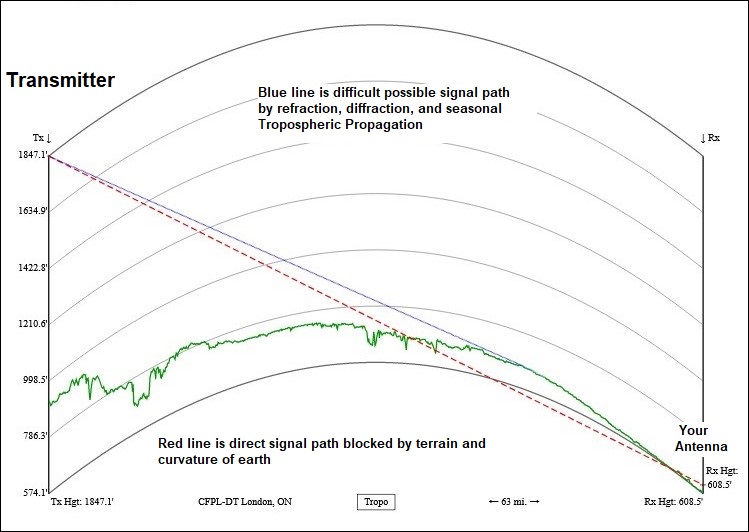

and there is terrain blocking the direct signal:
https://forum.tvfool.com/attachment....3&d=1622501168

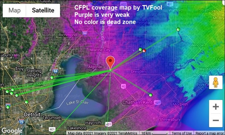

I certainly don't want to confuse you, I'm just going by what the rabbit ears.info signal report says. The report is only a computer simulation. It tells me that your location is outside the area of coverage for CFPL on RF channel 10, the direct signal is blocked by terrain, and it is listed as a Bad quality Tropo signal.
This coverage map is by rabbitears.info:
https://forum.tvfool.com/attachment....5&d=1622593477
https://forum.tvfool.com/attachment....6&d=1622594791
https://forum.tvfool.com/attachment....7&d=1622595647
https://forum.tvfool.com/attachment....8&d=1622596177
Signal reports for weak signals can be wrong. I consider reception of CFPL difficult, but not impossible at your location. CFPL is about 55 dB weaker than your strongest channel.
