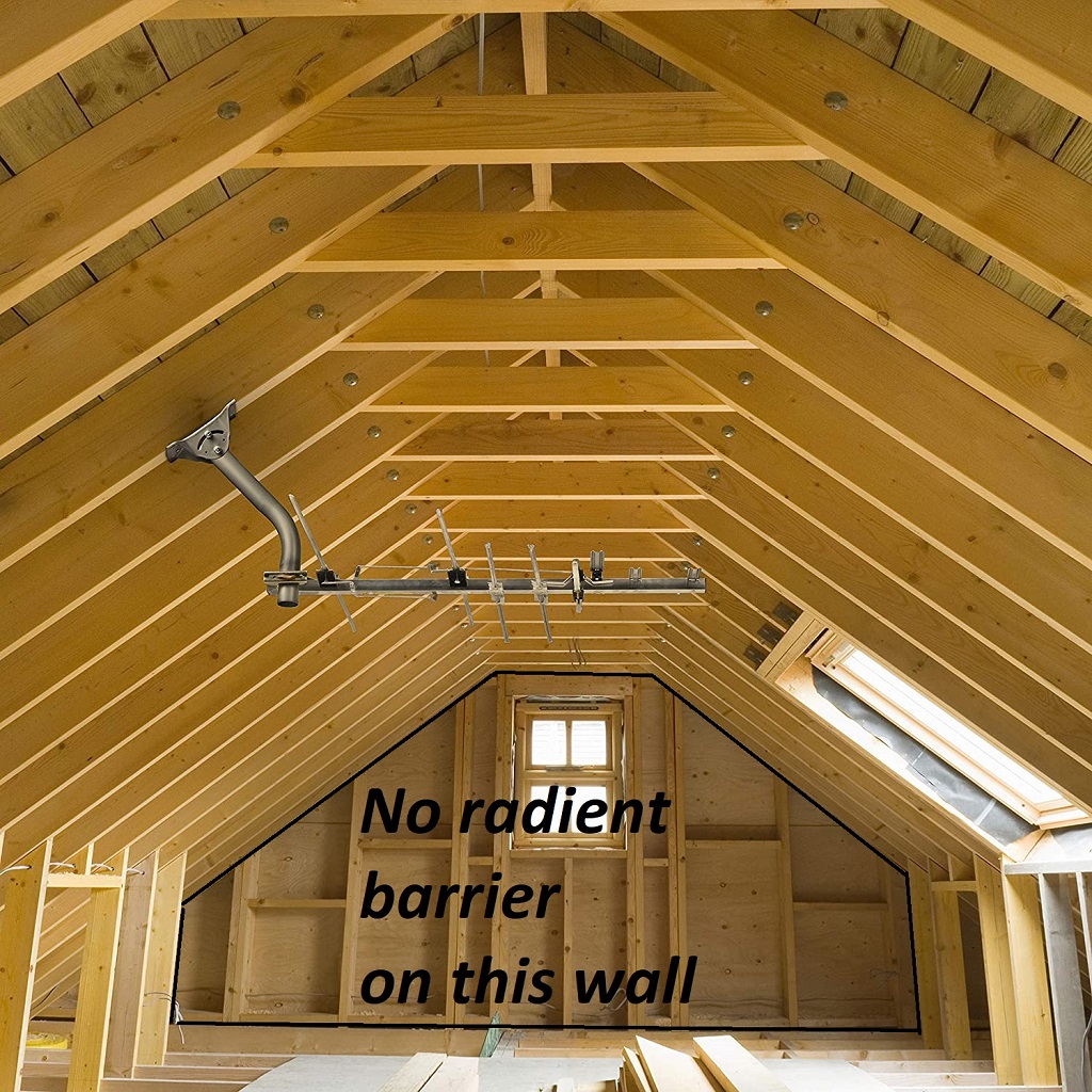

I have a RCA Outdoor Yagi antenna that I am currently using very successfully outdoors. Unfortunately I have to move it to an attic install and I found that I have radient barrier insulation on all but the west wall of the attic. Luckily I have to aim my antenna roughly west by northwest so it works out well.
I attached a pic (not of my actual attic) as an example of my situation. My question is, is that wall being free of the radient barrier enough to expect good results for an attic install?
Thanks,

Hello, Ken.
It is fortunate that there is no radiant barrier in the signal path, but there will still be some signal attenuation from the building construction.
Without a signal report from you for your location, you will have to make some tests to see if you need a preamp.

Thanks for your reply. I am hoping that any signal loss from the building materials will be offset by the additional height (I am going from about 12' to about 30').
Given that the roof-line is narrower on top and with adjacent radiant barrier, does it make more sense to mount the antenna closer to the floor to take advantage of the wider part of the wall or does it make a difference?

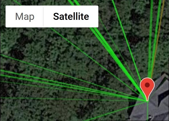

Thank you for the signal report. It gives me a better idea about how the signals arrive at your antenna in the NW end of the attic.
Only the ABC affiliate is coming in poorly. The quality is at about 45% to 50% and it's very spotty reception.
That is to be expected. WSOC is coming from a different direction (the North) and there are many trees in the signal path that weaken the signal and reduce its signal quality.

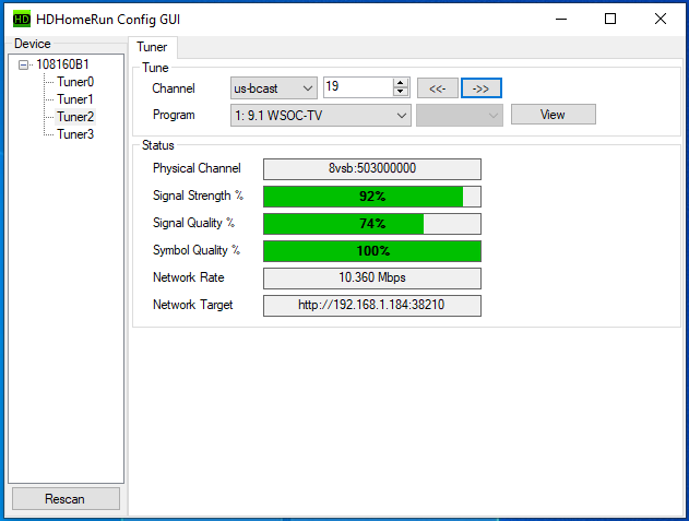

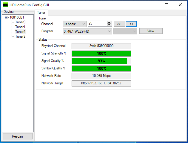

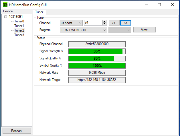

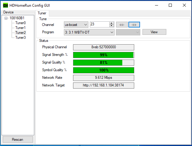

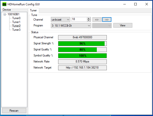

UPDATE:
Well the storms passed and there is no more wind. What a difference! No more glitches and look at the signal:
I never would have thought that a little wind could make so much difference.
Thanks again for your help!
Best regards,
Ken

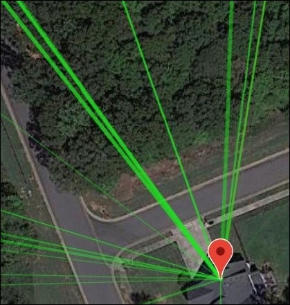

Thanks for the update and the GUI images, Ken. Those signals look good.
I had the wrong house. I think this is the right house. The end of the attic faces a little more to the north and the trees are a little further away.
