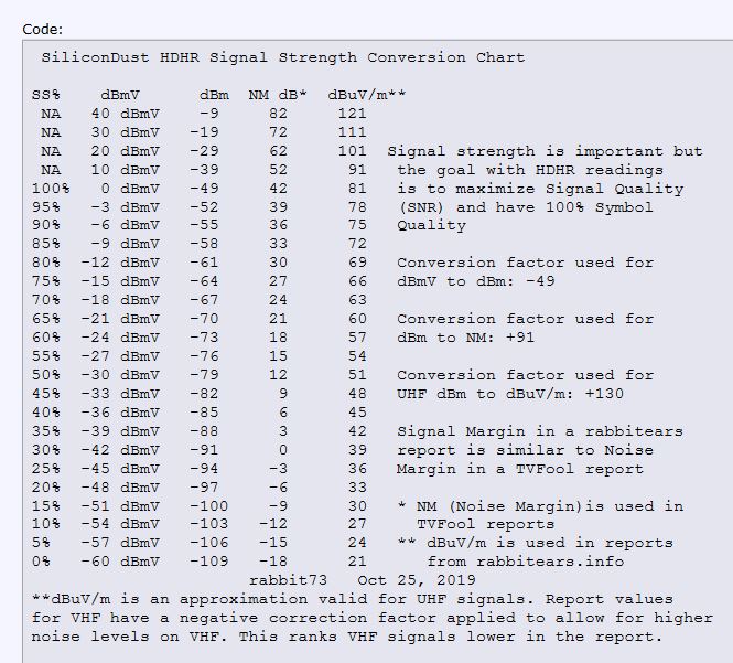

Code:
 SiliconDust HDHR Signal Strength Conversion Chart
SS%    dBmV      dBm  NM dB*  dBuV/m**
 NA   40 dBmV    -9     82     121
 NA   30 dBmV   -19     72     111
 NA   20 dBmV   -29     62     101  Signal strength is important but
 NA   10 dBmV   -39     52      91   the goal with HDHR readings
100%   0 dBmV   -49     42      81   is to maximize Signal Quality
95%   -3 dBmV   -52     39      78   (SNR) and have 100% Symbol
90%   -6 dBmV   -55     36      75   Quality
85%   -9 dBmV   -58     33      72
80%  -12 dBmV   -61     30      69   Conversion factor used for
75%  -15 dBmV   -64     27      66   dBmV to dBm: -49
70%  -18 dBmV   -67     24      63
65%  -21 dBmV   -70     21      60   Conversion factor used for
60%  -24 dBmV   -73     18      57   dBm to NM: +91
55%  -27 dBmV   -76     15      54
50%  -30 dBmV   -79     12      51   Conversion factor used for
45%  -33 dBmV   -82      9      48   UHF dBm to dBuV/m: +130
40%  -36 dBmV   -85      6      45
35%  -39 dBmV   -88      3      42   Signal Margin in a rabbitears
30%  -42 dBmV   -91      0      39   report is similar to Noise
25%  -45 dBmV   -94     -3      36   Margin in a TVFool report
20%  -48 dBmV   -97     -6      33
15%  -51 dBmV   -100    -9      30   * NM (Noise Margin)is used in
10%  -54 dBmV   -103   -12      27     TVFool reports
5%   -57 dBmV   -106   -15      24   ** dBuV/m is used in reports
0%   -60 dBmV   -109   -18      21      from rabbitears.info
                      rabbit73   Oct 25, 2019
**dBuV/m is an approximation valid for UHF signals. Report values
for VHF have a negative correction factor applied to allow for higher
noise levels on VHF. This ranks VHF signals lower in the report.
The last two attachments are the same chart. The Chart4-120.JPG is a little larger because it is at 120% of a BB code image in a post.
This is the Chart5-115 image for comparison with the original code image above:

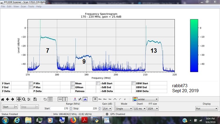

My marginal channel 9 signal looks like this; just barely enough SNR above the noise:

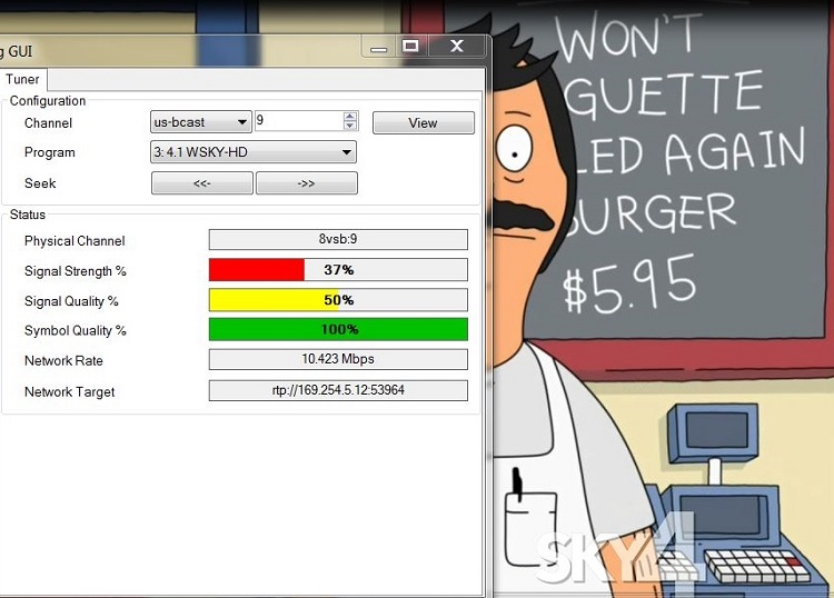

I adjusted the attenuator to make the signal weaker at the "Digital Cliff" to see which tuner would drop out first. To my surprise, the Sony tuner dropped out first; the HDHR tuner is more sensitive than I expected. It was still giving reliable reception at 50% Signal Quality.

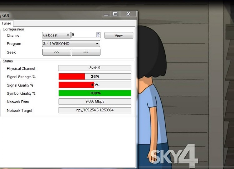

At 49% Signal Quality, the Symbol Quality often dropped down into the red at lower readings:

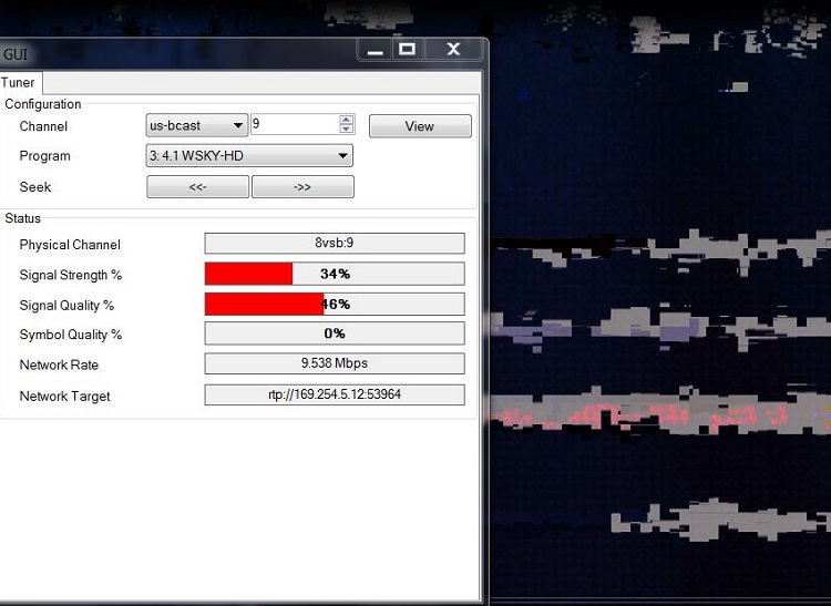

and finally dropout:

I get similar results with my HD Home Run connect. As long as the signal strength is at least 50% and the SNR is 50% or above (yellow colour) the station is watchable. IF SNR drops below 50% (red) it is unwatchable.
