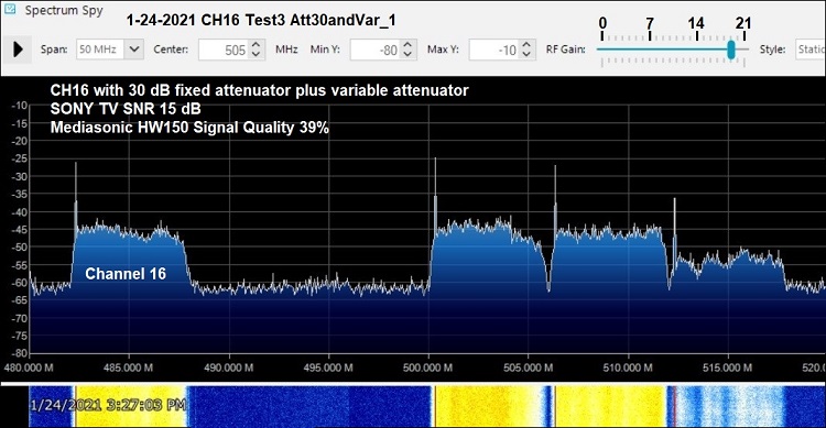

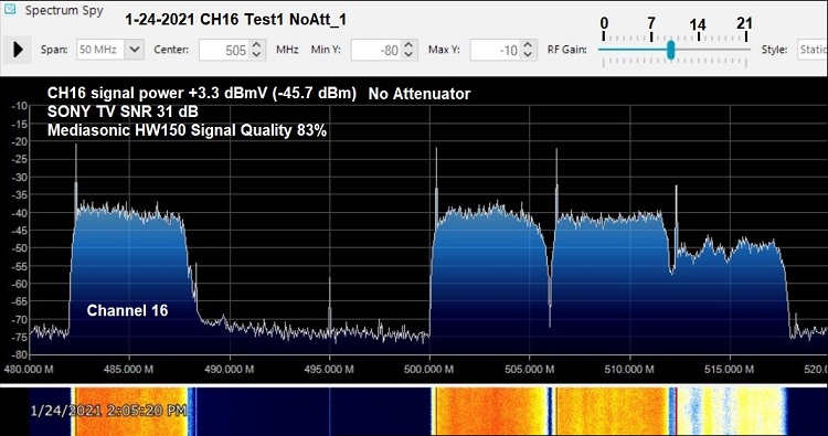

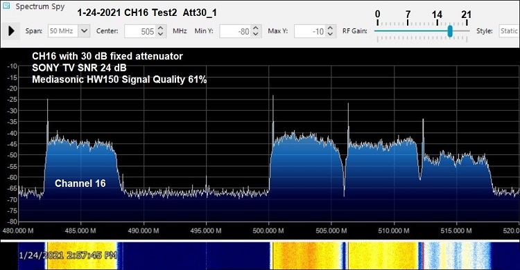

Here are the screenshots of the CH16 signal at SNR 31, 24, and 15 dB:
http://forum.tvfool.com/attachment.p...9&d=1611588457
http://forum.tvfool.com/attachment.p...0&d=1611588474
http://forum.tvfool.com/attachment.p...1&d=1611588492

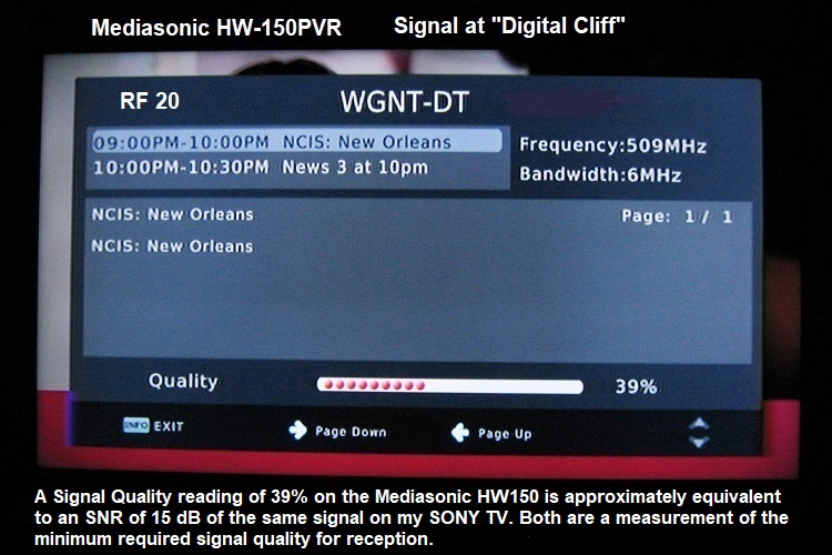

This is a screenshot of the Mediasonic HW150 for CH20 at the "Digital Cliff."
http://forum.tvfool.com/attachment.p...2&d=1611589019

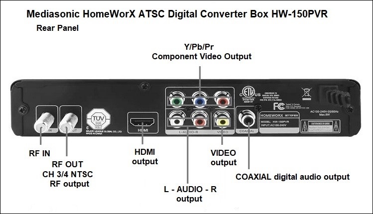

The Mediasonic HW-150 has a built-in power supply and outputs for HDMI, Component, and Composite. (Composite is also known as CVBS for Composite Video Baseband Signal) The less expensive HW-130 has a separate wall-wart power supply and outputs for HDMI and Composite; no Component output.
http://forum.tvfool.com/attachment.p...4&d=1611761912
Both models are able to add a channel after scan, which is very useful if you have more than one antenna or a rotator. Tyler the Antenna Man uses the HW-130 for antenna comparisons.
http://forum.tvfool.com/attachment.p...3&d=1611760402
