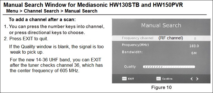

Tyler has a lot of good ideas. One of the converter boxes that he uses is the Mediasonic HW-150PVR. It has a signal quality indicator that is very useful.
Signal dropout is at about 39 to 40%:
It also is able to add a channel after scan so that you don't have to rescan if you change antennas or antenna direction. A lot of TVs can't do that.
File Type: jpg Mediasonic HW130-150 Manual Search2.jpg (113.6 KB, 4214 views)

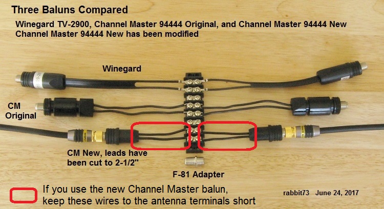

Did you see this thread by BigHenry? He has a CM5020 and had balun problems.
https://forum.tvfool.com/showthread.php?t=16704
He replaced the PCB balun with a CM94444 balun. It didn't work too well until he shortened the leads to 2-1/2" as I had suggested in my balun tests.
New Channel Master Balun
https://forum.tvfool.com/showthread.php?t=16297
