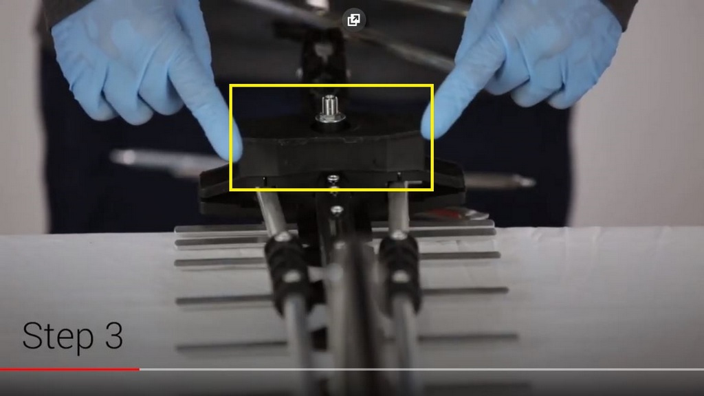

Couldn't say for sure since I've never seen that antenna up close, but looking at the YouTube video for assembly of your antenna, it looks like the balun assembly is an integral part of the antenna.
