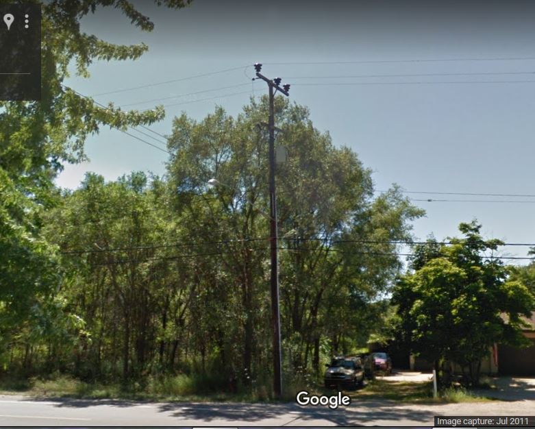

part of my problem is i have a power transformer out in the front like 75' away and one time years ago the neighbor had an antenna guy trying to hook up an antenna and he told me that transformer gave him fits. hw was from an antenna company in the area.
Yup, powerline noise can cause interference to TV signals, especially on VHF like WZZM ABC on 13 and WGVU on 11.
yep that is the pole i have in my side yard looking out to the grand rapids area. you got it good. thanks
