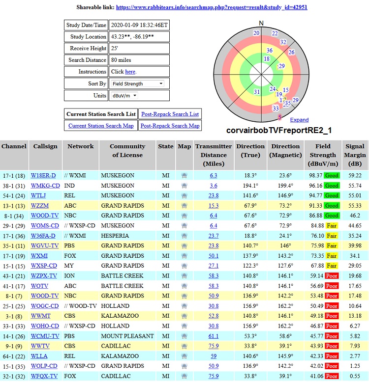

rabbit73 9-Jan-2020 11:48 PM
1 Attachment(s)
Originally Posted by corvairbob (Post 62583)
in the tv that show signal strength i get 40 for most channels and 60 for a few so it is dependent on the power the stations have.
rabbit when i was setting up my system we went all over this.
OK, you're going to make me hunt for it. I looked at your previous thread for the missing details since you didn't want to give them here. Is this report correct for your location?
https://www.rabbitears.info/searchma...study_id=42951
https://forum.tvfool.com/attachment....4&d=1578614982
for some reason i lose signal when i have 2 antenna point to the same direction. the tv station calls it atmospheric disturbance. i calle bunk but if i take one off line sometime i get better signal. and then sometimes i have to put it back online
I call it a problem with your method of combining. Using a splitter in reverse as a combiner is easy, but it usually doesn't work very well. The same signals from each antenna interfere with each other when they get to the combiner.
If you don't have all the signals when combined that you had when the antennas were separate, that method of combining doesn't work for you.
i also have a post amp/splitter for 4 tv's and for the most part they do good. now and then i lose 8 or 29 . i didn't watch 8 much but i watch 29-2 a lot as it has cozy and i like that programming. thanks
If COZI-TV is important to you, you will need a separate antenna for WOMS-CD. It's very low power; only running at 0.7 kW ERP, which is about as much as a toaster uses.

corvairbob 9-Jan-2020 11:59 PM
thanks. i have one of them pointed at that tower now. and the yagi is point more to that channel and to g.r. .
that splitter is a both wat unit. it does either in or out on all the ports. i got it form a tvfool vender way back when i was setting my system up the firs time about 2 years ago. he is in the lansing area and use to live over my way. he sells the double antenna system that is a stacked unit. i may wind up getting that system next summer and mounting it a bit higher and then put a rotator on it. i hate to rotate the antenna because multiple tvs run form them and if i move to one station then i lose the signal for other tv's.
i would like to find a omni directional antenna. i have one i got from the guy that had the tv station in muskegon a few years ago but he died and i do not have it anymore, i installed it at my girls house. she gets the stations better than i do. but i can't take her stuff down now. what i should have done was taken it apart to see how he made it and then just copied it.
maybe someone here has one or know someone that builds them. thanks

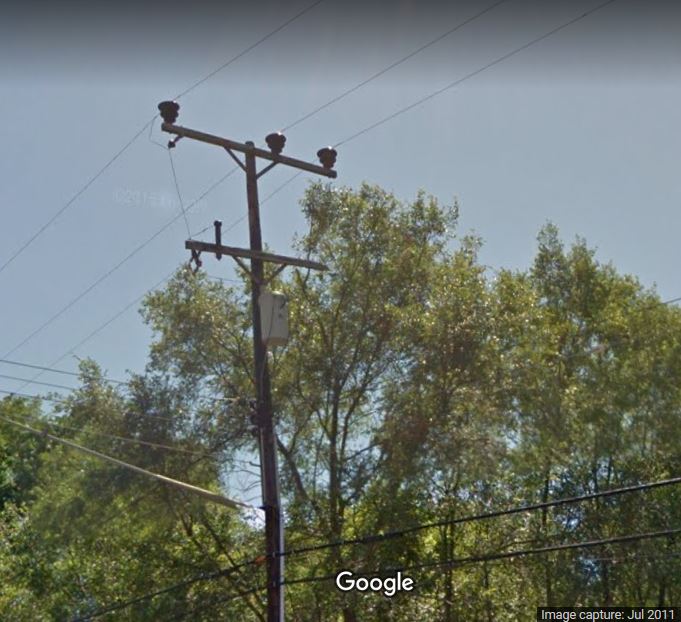

part of my problem is i have a power transformer out in the front like 75' away and one time years ago the neighbor had an antenna guy trying to hook up an antenna and he told me that transformer gave him fits. hw was from an antenna company in the area.

rabbit73 10-Jan-2020 1:11 AM
2 Attachment(s)
Yup, powerline noise can cause interference to TV signals, especially on VHF like WZZM ABC on 13 and WGVU on 11.

corvairbob 10-Jan-2020 2:39 PM
https://forum.tvfool.com/attachment....6&d=1578660290
yep that is the pole i have in my side yard looking out to the grand rapids area. you got it good. thanks
