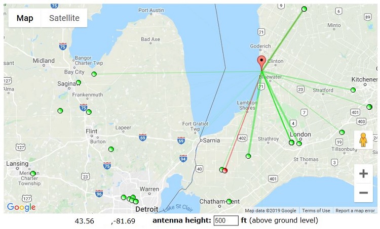

These are the Repack changes for Detroit:
Phase 8 is 1/18/2020 to 3/13/2020.
This is the map for 73 feet:
I had to set the antenna height to 500 feet before the green signal line to Bay City would come on. The Detroit lines didn't come on:
The red marker is your location.
