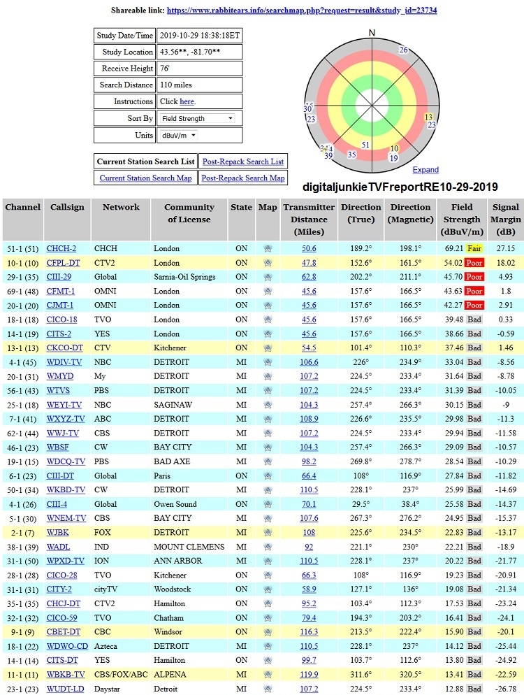

For comparison, here is a report from rabbitears.info that is based on my guess of your location:
https://www.rabbitears.info/searchma...study_id=23734
This is an extract from that report:
https://forum.tvfool.com/attachment....4&d=1572390420
That's an impressive tower. I agree with GroundUrMast, you are doing very well but have reached the point of diminishing returns. It would require a lot more effort even for a small improvement.

These are the Repack changes for Detroit:
Phase 8 is 1/18/2020 to 3/13/2020.
This is the map for 73 feet:
https://forum.tvfool.com/attachment....5&d=1572391541
I had to set the antenna height to 500 feet before the green signal line to Bay City would come on. The Detroit lines didn't come on:
https://forum.tvfool.com/attachment....6&d=1572391577
https://forum.tvfool.com/attachment....7&d=1572392802
The red marker is your location.
