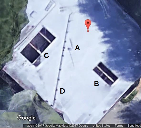

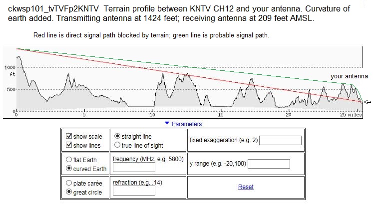

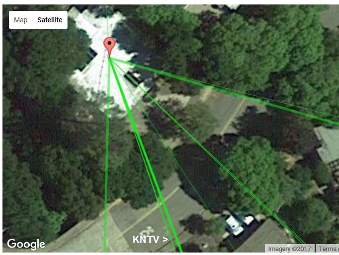

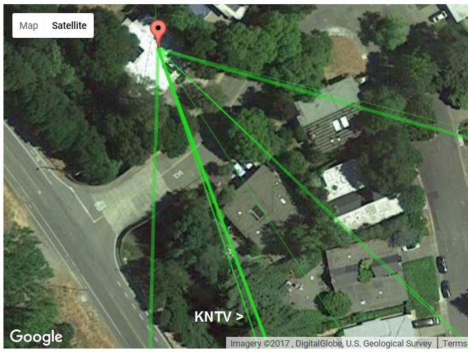

Thanks for the oblique satellite photo; it helps.
Here is the KNTV terrain profile:
Is the antenna here (I used the vertical instead of the oblique):
or here:
Is the antenna at the teardrop or at A.
Are B and C solar panels? Thermal or PV?
Do you have an inverter? They can cause interference on VHF.
What is D?

Antennas placed at the tear drop.
At this position UHF channel reception is fine.
VHF RF 12 gradually degraded over the last 6 months.
I can view alternate KNTV NBC 11.3 on RF 49 from Mt Allison San Jose.
B and C are open areas.
D is over the roof copper water pipe repair done 10 years ago.
Nearby houses do have roof solar systems. I would expect panel interference
to be greater during the day and less during the night. I will take more measurements
using the SiliconDust diagnostic program.

Looks like the signal path is between two trees.
Tree growth?
