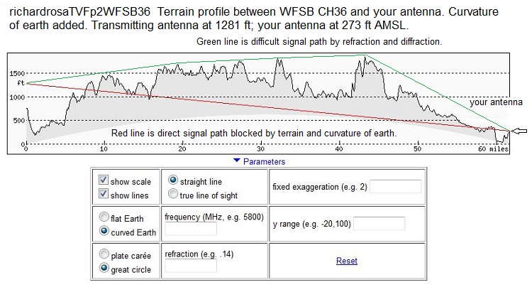

You are in a poor location for OTA reception, Richard. If you click on Transmitter Distance in your rabbitears.info report, you will see how the terrain blocks the signals. Reception will rarely be 100% reliable for most channels.
Small differences in elevation are because different databases were used.

It's probably because of temperature inversion.
Definition of subrefraction
: a state of refraction (as of the atmosphere) that is less than normal and is usually associated with a sharp vertical gradient of some physical factor (such as temperature)
