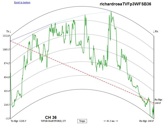

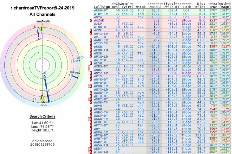

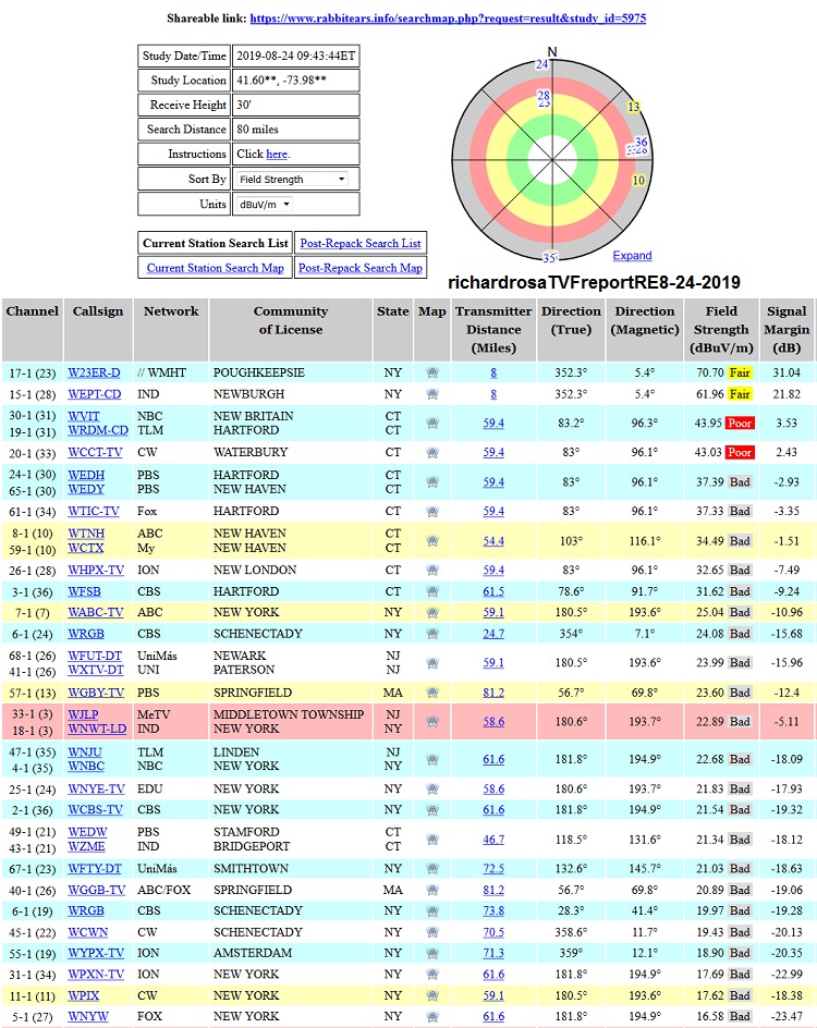

rabbit73 24-Aug-2019 3:17 PM
4 Attachment(s)
Hello, Richard
Your previous TVFool report is no longer on the server:
http://www.tvfool.com/?option=com_wr...d6dbf19cecb97a
and a current TVFool report isn't accurate:
http://www.tvfool.com/?option=com_wr...903868a4614e1a
https://forum.tvfool.com/attachment....3&d=1566654647
but a report using the rabbitears.info search map is more up to date:
https://www.rabbitears.info/searchma...&study_id=5975
https://forum.tvfool.com/attachment....4&d=1566656234
You are in a poor location for OTA reception, Richard. If you click on Transmitter Distance in your rabbitears.info report, you will see how the terrain blocks the signals. Reception will rarely be 100% reliable for most channels.
https://forum.tvfool.com/attachment....5&d=1566659328
https://forum.tvfool.com/attachment....6&d=1566659349
Small differences in elevation are because different databases were used.

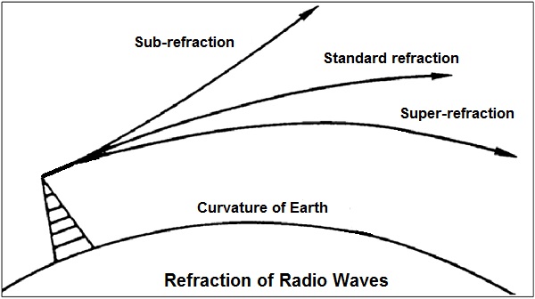

rabbit73 25-Aug-2019 1:52 PM
2 Attachment(s)
Originally Posted by richardrosa (Post 62107)
WFSB's signal has been mysterious since day one. Between the minute to minute fluctuations and the level reduction in daylight, It always seems to behave like a short-wave signal, rather than a UHF frequency. All the other stations provide a pretty stable level.
Rich
It's probably because of temperature inversion.
https://forum.tvfool.com/attachment....7&d=1566737536
Definition of subrefraction
: a state of refraction (as of the atmosphere) that is less than normal and is usually associated with a sharp vertical gradient of some physical factor (such as temperature)
https://forum.tvfool.com/attachment....8&d=1566743887
