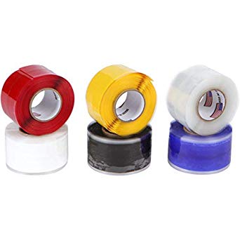

I prefer silicone fusing tape to the coax seal. It adheres to itself and fuses together. It leaves no residue when removed. You can simply slit it gently with a razor knife and peel it off easily if you have to remove it. The bond is permanent, waterproof, resists weathering and UV deterioration. It stretches around uneven shapes and forms a really tight seal. I use it for all my TV and ham radio antenna connections. I have opened up connections that are over 10 years old and found them just like the day I installed them. It is really great stuff.

I was reluctant to undo the coax connections up in the tree, for fear of messing something up unnecessarily. So rather than take the connections apart and applying grease, I decided to just use the silicone fusing tape that Tim recommended. I wrapped the tape tightly around each coax connection and it seemed like it would be a pretty water-resistant seal. I also replaced some of the zip-ties up there with UV-resistant versions and trimmed a couple of branches while I was there. Hopefully the setup will continue to function well (all five major networks from 72.5 miles away) for many years to come.
