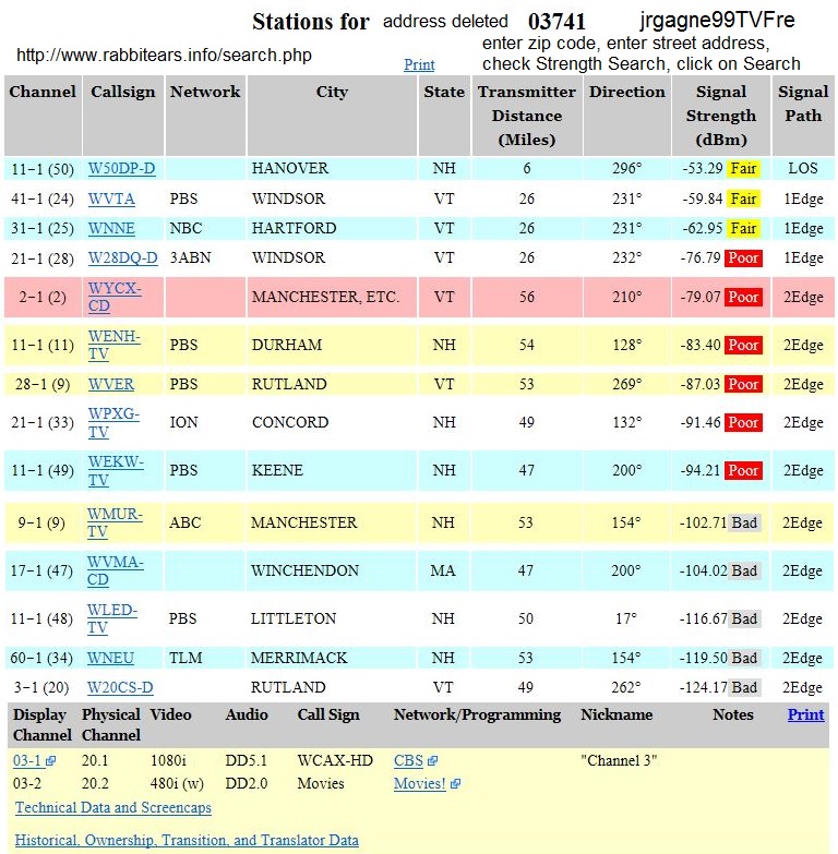

Is it possible you are receiving the WCAX translator, W20CS? It has the same virtual channel number. Do any of your TVs give the real channel number or frequency of a received channel in the menu?
http://forum.tvfool.com/attachment.p...1&d=1474412225

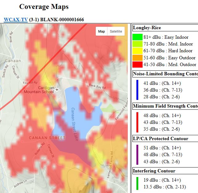

It is curious that it is one of the only signals on my TVfool report that does not have a birds-eye-view signal strength plot available for it.
Yeah, I noticed that the coverage map was not available from the tvfool Interactive Map Browser. That made me wonder if it was really on the air. I did find a Longley-Rice coverage map on the FCC contour map:
http://www.rabbitears.info/contour.p...2.816111111111
Red is weak, no color is weaker. You can see the coverage in your area is very spotty because of the rough terrain. A small change in location can make big difference in signal strength.
http://forum.tvfool.com/attachment.p...1&d=1474412942

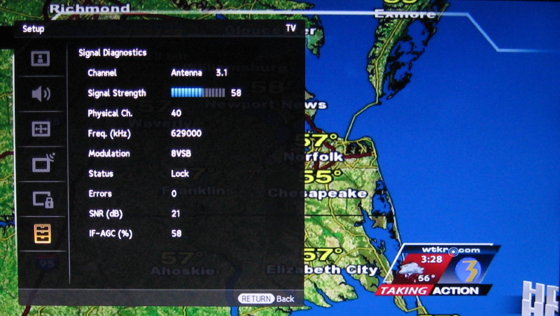

I'm pretty sure it is not W20CS. With my TV in "manual" mode, when I type in "22" it automagically goes to 3.1. If I type in "20", it stays put and says "no signal". Unfortunately, the other TV is the same type, only smaller, and all the menus are exactly the same. They are circa-2008 Sylvanias.

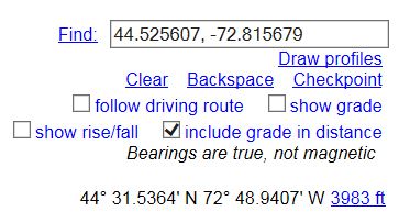

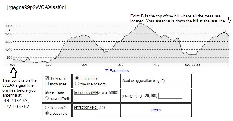

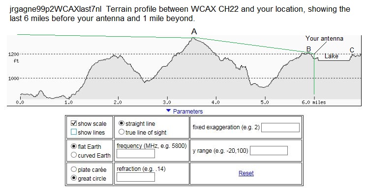

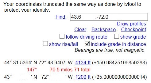

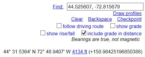

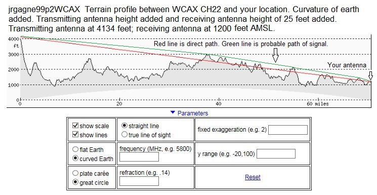

This is the terrain profile for WCAX from tvfool:
http://www.tvfool.com/?option=com_wr...dALLTV%26n%3d7
This is the profile using different software:
http://forum.tvfool.com/attachment.p...1&d=1474416565
http://forum.tvfool.com/attachment.p...1&d=1474416999
The WCAX signal passes over two ridges, which causes scattering, resulting a non-uniform field as you saw on the hdtvprimer page. Point A is further out; point B is just before your antenna. I can see the ridge at point C behind your house. Using "what if" height changes on the interactive map browser:
At 115 ft 1Edge NM 17.6 dB; the signal clears point B
At 485 ft LOS NM 41.0 dB; the signal clears point A
What bothers me is, if the terrain affects WCAX, then why doesn't it affect WPTZ?
I suggest you hunt for a good location for WCAX (somewhere on you property even if it means a mast behind the house) using the HDB91X with the front of the antenna tilted up (15 deg ?) to catch the signal coming down from the ridge. You need to get the antenna as high as you can because there is a lot of ground clutter on the hill just in front of the antenna.

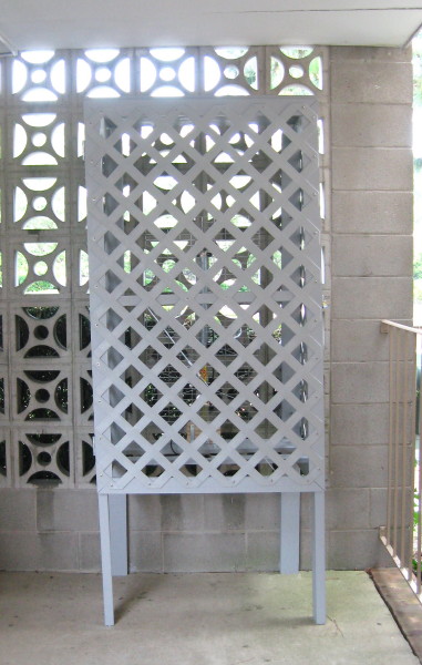

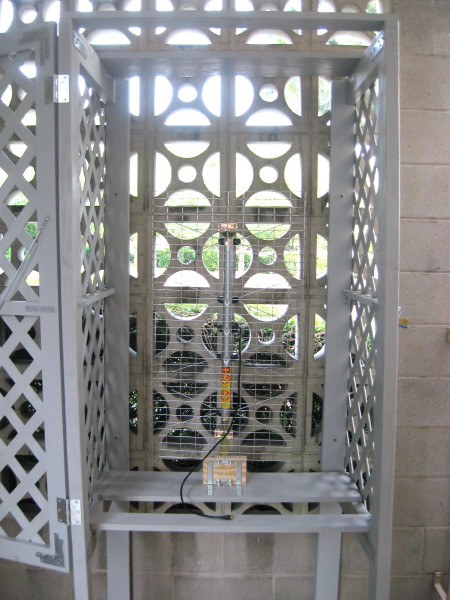

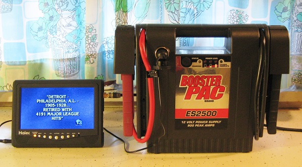

If I do "walk the roof" and happen to find a hot spot for WCAX, do you think the hot spot will stay in the same place from day-to-day, and over the seasons and years?
The hot spot stayed stable for me. My wife wanted a battery operated TV for use during a power failure. The only place it would work indoors with analog TV was by a window.
http://i496.photobucket.com/albums/r...pshazyfqkd.jpg
When digital TV came along, an indoor antenna would not work because there was an aluminum foil vapor barrier on the insulation in the outer walls; we were living in a Faraday Cage.
The landlord said I could mount an antenna outside if it did not show from the street. I selected a hot spot inside the decorator blocks on the porch. The landlady said she wanted me to move it to the left where it wasn't as obvious. I explained to her that the antenna needed to be where the signals were the strongest, and I would build an attractive enclosure for the antenna. She said OK.
http://forum.tvfool.com/attachment.p...1&d=1474419910
The 4-bay UHF antenna is about 5 ft off the ground. I added a folded dipole for VHF channel 13. The signals come through the holes in the blocks without much attenuation. The VHF signals are attenuated a little more because the size of the holes is frequency related. In other words, the holes act like a high pass filter.:)
