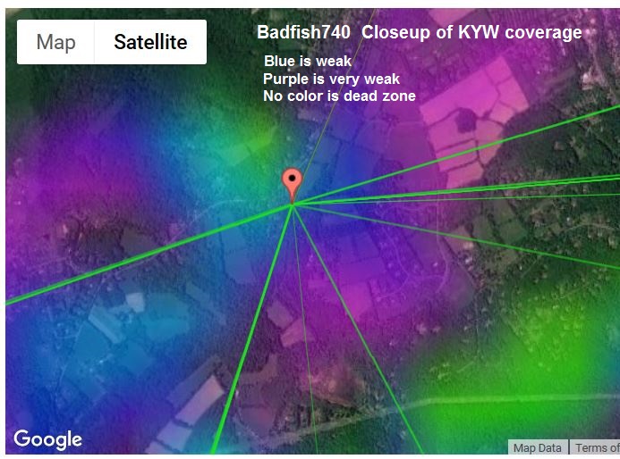

This is an image of your report:
This report from rabbitears.info should have a more accurate list of channels:
You can see you are on the fringe:
