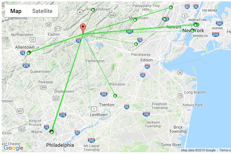

rabbit73 15-Jun-2019 8:49 PM
6 Attachment(s)
https://forum.tvfool.com/attachment....5&d=1560628061
Originally Posted by Badfish740 (Post 61743)
I sent rabbit73 my address for further analysis, so we'll see what he comes back with,
Thank you for the exact address. The summer Google aerial view shows a lot of trees around your house, but the ground photo looks more open.
I did some investigation of my own via Google "My Maps" which allows one to plot coordinates on a map (ie: My house, various transmission towers) and draw lines between them.....the line between my house and the Roxboro towers runs right through one 800+ foot peak, so not sure how that would impact signal.
I see the peak. Reception looks difficult, but not impossible.

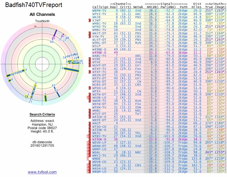

This is an image of your report:
https://forum.tvfool.com/attachment....6&d=1560628114

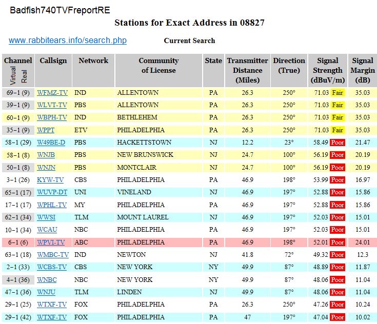

This report from rabbitears.info should have a more accurate list of channels:
https://forum.tvfool.com/attachment....7&d=1560628147

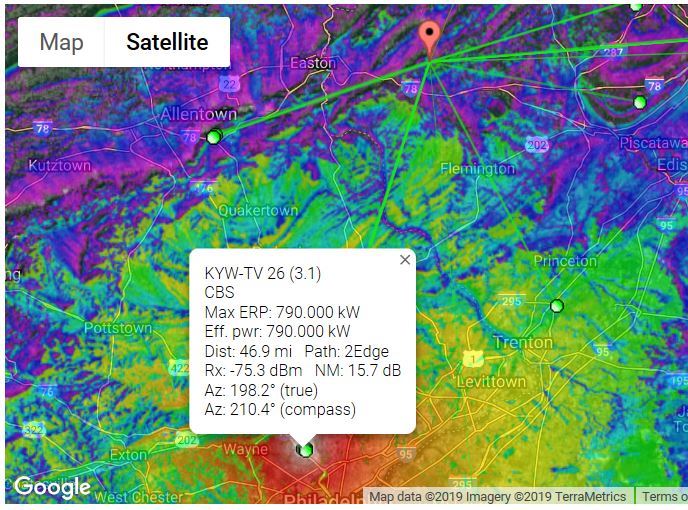

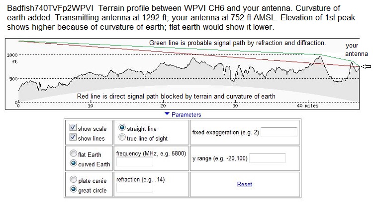

You can see you are on the fringe:
https://forum.tvfool.com/attachment....9&d=1560629031
https://forum.tvfool.com/attachment....0&d=1560629067
