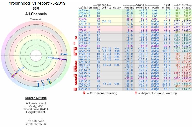

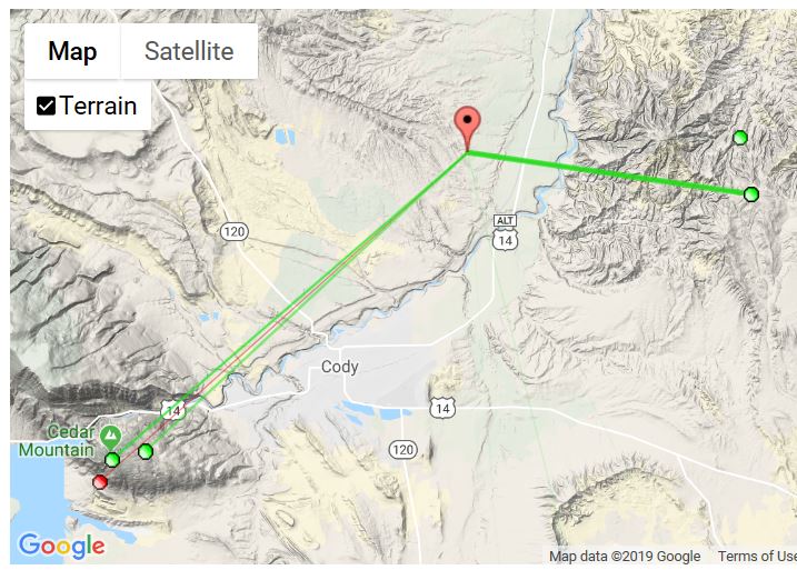

The translators to your southwest are duplicates of those over by Cody.
A simple UHF-only antenna aimed at Cody should be all you need. Shouldn't need an amp, the calculated signal levels are pretty good and, as long as you can mount the antenna so it has a clean view in that direction, should work fine.
Something along the lines of a DB4e and a 30" or 40" J-mount should work fine.

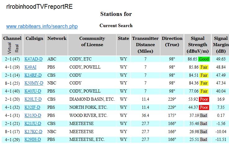

Old 3-Apr-2019, 7:15 PM   #5
Originally Posted by rlrobinhood View Post
I do have one followup question. How can you tell if translators are duplicates? I'm just curious.
Hello, rirobinhood
This is an image of your report:
This report from rabbitears.info has a more accurate list of channels and shows the networks:
The channel changes because of Repack by the FCC are indicated by the arrows:
https://www.rabbitears.info/market.p...callsign=k47ad
Click on callsign to see subchannels.

Old 3-Apr-2019, 10:28 PM   #6
I cross-checked them on rabbitears.info, just like rabbit73 did.
