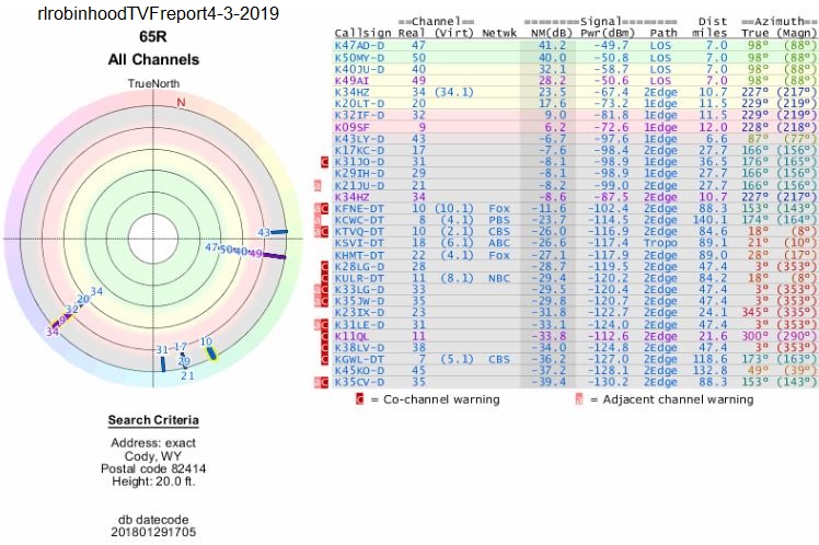

Above are three reports I ran on the webpage. What I'm looking for is recommendations for antennas and any accessories you think I will need. I can place the antenna(s) on the SE corner of my house and can put the antenna(s) above the roof line about 20' off the ground. The cable run from the antenna(s) location to my tv is approximately 60'. So my questions are:
1) It appears I have two clusters of repeaters/translators to the east and to the southwest. Unfortunately, they are in quite different directions. Can you make an antenna recommendation for me or if you think two antennas is a better approach can you recommend the two you think would be best?

ADTech 3-Apr-2019 1:58 AM
The translators to your southwest are duplicates of those over by Cody.
A simple UHF-only antenna aimed at Cody should be all you need. Shouldn't need an amp, the calculated signal levels are pretty good and, as long as you can mount the antenna so it has a clean view in that direction, should work fine.
Something along the lines of a DB4e and a 30" or 40" J-mount should work fine.

rabbit73 3-Apr-2019 8:15 PM
3 Attachment(s)
http://forum.tvfool.com/attachment.p...7&d=1554318756
Originally Posted by rlrobinhood (Post 61134)
I do have one followup question. How can you tell if translators are duplicates? I'm just curious.
Hello, rirobinhood
This is an image of your report:
http://forum.tvfool.com/attachment.p...1&d=1554318839
This report from rabbitears.info has a more accurate list of channels and shows the networks:
http://forum.tvfool.com/attachment.p...9&d=1554318821
The channel changes because of Repack by the FCC are indicated by the arrows:
https://www.rabbitears.info/market.p...callsign=k47ad
Click on callsign to see subchannels.
ADTech 3-Apr-2019 11:28 PM
I cross-checked them on rabbitears.info, just like rabbit73 did. ;)
