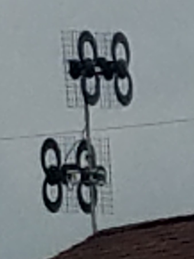

Funny, I was driving through Kenosha WI, I saw this array:
I know it's not the MAX, but someone got crafty. Actually, I've seen a few of these array near the state line as you say.
And, I thought I saw two C4MAX's combined, somewhere. Easily distinguished by no reflectors, correct?
I always thought they were novelty antennas and overlooked them.

Hi Rabbit,
Yes, I am listening to the whole thread here.
The 8 Bay idea has me very interested. Your pattern tells me that it could be the answer.
A while back, I saw a 4228 double stacked in this test, can't find it right now,.
AD Tech suggested the C4MAX. Have you done any testing with the C4MAX?
One advantage would be the lesser windload, at least that's what it appears to a layman like myself
Also, I guess my XG91 is a lifetime warranty, that's good. I may warranty it and save it for other uses.
The balun issue is interesting to me. in the automotive industry, that causes major issues. Also known as pin fit.

AD Tech, what would you say the wind load is on these C4 / Max antennas?
So, the C4-V-CJM, I have been researching/reading. AD says it's re-engineered from the original C4. What did they do to improve it?
I imagine it has to be better, since its more expensive even without reflectors
Also, you mentioned that it is highly recommended along the WI-IL State line, that must be true since I see a lot of them. I should clarify. I see a lot of the the C4's with reflectors, usually aimed in opposing directions.
Wouldn't they have been smarter to keep both and remove the reflectors? or even just one? Or, is the original C4 useless w/o the reflectors?
My experience has taught me that it's a bad idea to combine antennas pointing in two opposite directions.
I found a decent price for the C-MAX on Amazon, ($120.00) so I was thinking about purchasing one or two.
It also appears they still have some of the original CS4Vs with reflector for $109. Would that be a better deal?
Thanks, Bob
