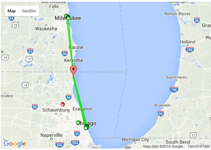

Bob lives in Zion, IL midway between Milwaukee and Chicago and wants to receive signals from both cities but doesn't want to use his rotator except for fine adjustments. He realizes that combining the two antennas doesn't always work and for now is considering separate coax lines. He also understands that it is possible to remove the reflector from a UHF bowtie antenna to make it bi-directional for both cities with some limitations.
http://www.tvfool.com/?option=com_wr...51346a60b4196b

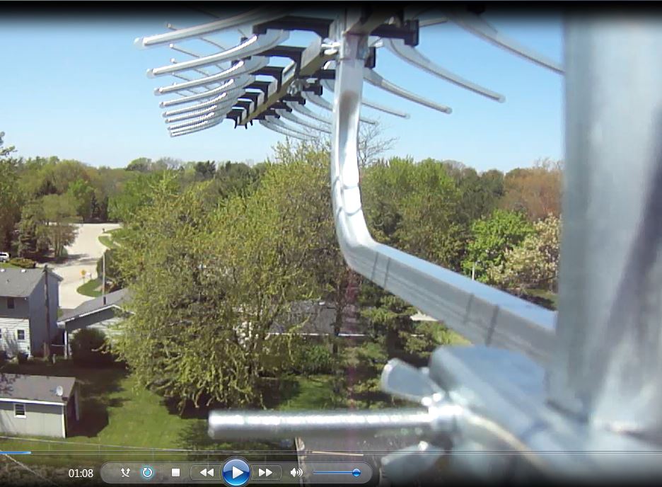

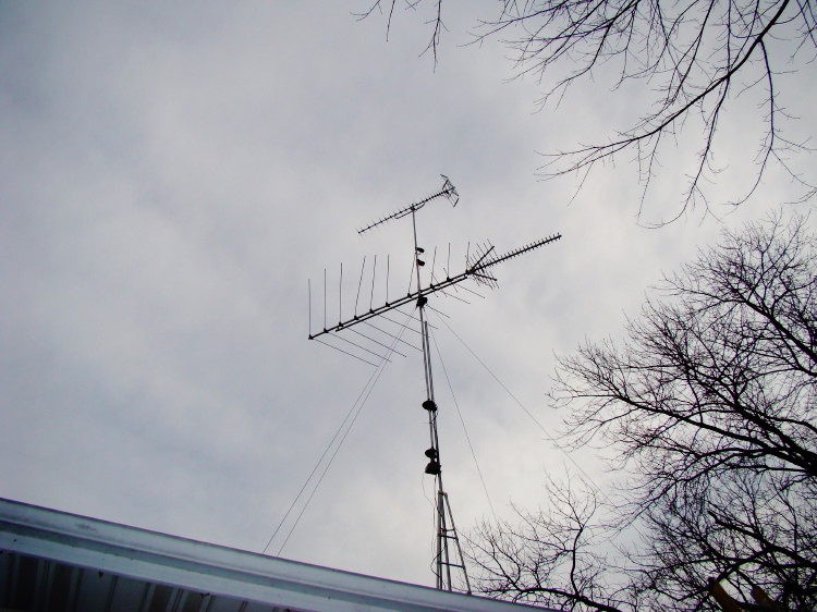

His main concern now is safe mounting of his antennas in the land of the "Windy City."
He presently has a HDB91X UHF antenna at the top of the mast aimed at Milwaukee, and a Radio Shack VU-210XR VHF/UHF antenna below it aimed at Chicago, depending on rotator aim.
He is surrounded by tall trees and is trying to raise his antennas high enough to clear them. He made a video with the camera creatively mounted on a 20 ft pole to take photos at antenna height. I made two stills from the video. The first is the UHF antenna aimed at Milwaukee:
the second is the RS antenna aimed at Chicago, which has the stronger signals:
Bob's PM:
Be sure to look at video #3; there is a LOT of antenna movement in the wind. The music is wind chimes.

This morning we are having high winds. The weather says 22 MPH winds, 53 MPH gusts and since I don't anemometer, I have to believe it.
I feel that before I add any more antennas or raise the mast, I will have to go heavier on the antenna mast pipe or sleeve it.
Here's some more award winning Video. The wind noise is a little irritating, especially the ones from standing on my rooftop. At one time, it felt unsafe, even just with a small video camera. "Now, that was a gust":

Also, I could go closer to the top with my guyed thrust bearing and/or add another guyed bearing under.
Is there any effect on reception with guy wires? Mine are 3/16".
I am going to revamp the whole antenna arrangement and make it more wind worthy.

1) I will have another tripod "north array" for Milwaukee and I have the HDB91X that I will join with the 2nd 30-2476 using a UVSJ.
2a) Sleeve my 1 3/8" antenna mast with 1" SCH 40 galvanized water pipe, through bolt it on a few places, raise the guyed thrust bearing to just under the VHF antenna. This should eliminate the twist seen in the videos.
2b) I also have a guy wire collar to support the lower mast if needed.
3) Install the XG91 at the top with the 30-2476 under by just a couple of feet so the unsupported mast is only a few feet over the guyed bearing. ("south array")
BTW, I designed a heavier duty thrust bearing for joining both masts. It is over kill, but I plan to leave it up a long time, I'll send pics later, it is done, just waiting for the cold galvanizing to set up.
For now, I bought a UVSJ and will join the VHF and UHF.

Project one 95% complete...
Well, This one is just about done.
I bought a 91XG and a Stellar Labs 30-2426 and stacked them. I used an RCA PREAMP1 to combine them. Signal strength was over 82% before I raised the mast over the trees.
I am using input one on my Toshiba TV.
I also added my super duty mast thrust bearing as far up as I could get it. My light duty design is there also for test purposes.
I moved the Guyed thrust bearing much higher and sleeved the 1 3/8" Pipe with the 1" SCH40 and thru bolted them to make them work together and cut down on twist. Those modifications should make it much more stout.
Although I went a little higher, I am satisfied with my tree clearance.

Hi, Bob:
You are making a lot of progress.
30-2426? You must mean 30-2476.
The mast sounds much more safe and secure.
Thanks for the new video. It's just like I'm up there with the antennas; very exciting.

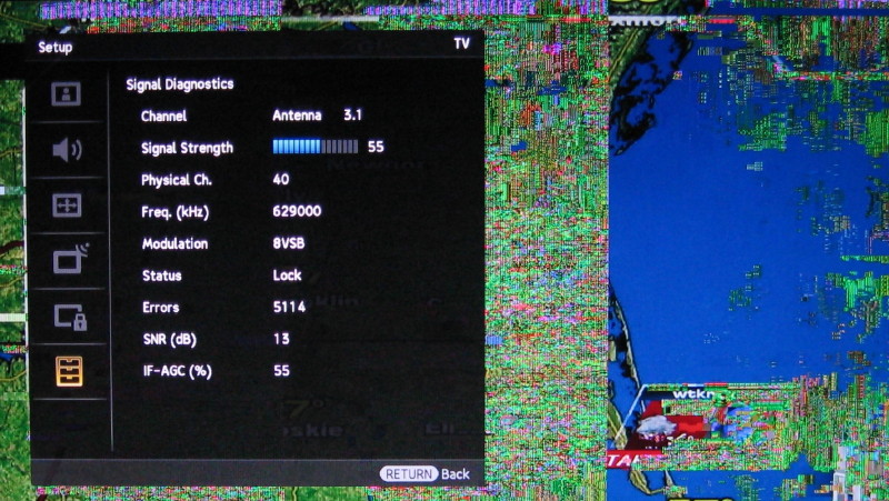

When aiming an antenna, I first adjust for max signal strength. Then I monitor signal quality for final adjustment. Max signal quality isn't always at the same azimuth as max signal strength, usually because of multipath reflections that create a non-uniform field.
My Sony KDL22L5000 has a Diagnostics Screen that gives signal strength, SNR, and uncorrected errors.
Bad signal with picture freeze, SNR below 15 dB, and errors:

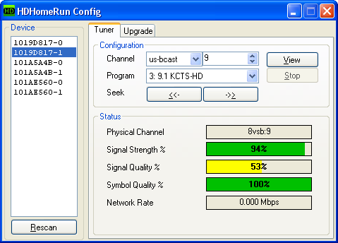

It is also possible to check signal quality with converter boxes or external tuners that have two signal bars, one for signal quality (the inverse of uncorrected errors), and one for signal strength, like the Apex DT502 or Centronics ZAT502HD:
You can also use the Diagnostics Screen of the TiVo Roamio that gives signal strength, SNR, and the inverse of uncorrected errors; see attachment 1.
or the SiliconDust HDHR that shows signal strength, signal quality (SNR), and symbol quality (inverse of uncorrected errors):
That image is from a thread by GroundUrMast:

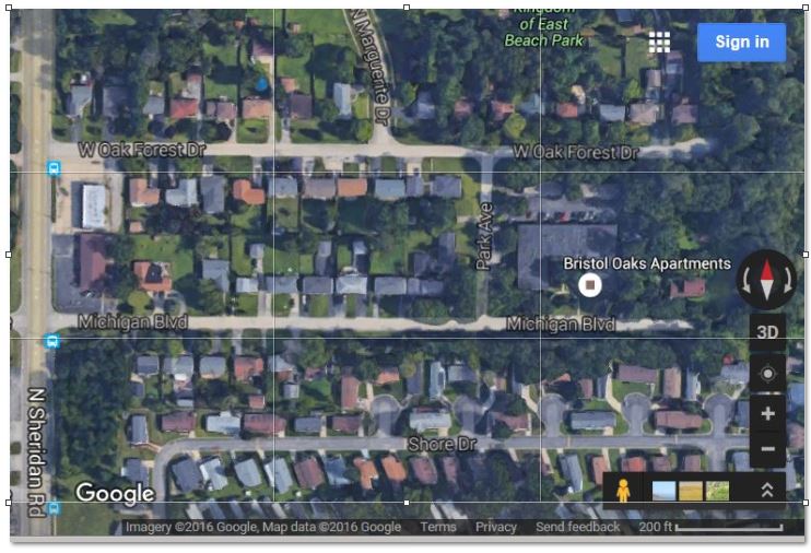

Latitude
As unimportant as this may seem, My neighbor who claims to know much about OTA TV looked at the aiming of my antennas.
He had his own theories about aiming and provided me with the compass. When I synched my CM9521A north and south, he thought it was off by several degrees. I stated it was square with the road, he said that that was a problem because my road Michigan Blvd is not square with longitude and latitude.
Is there a way to use google earth or other mapping program to show lines of latitude or longitude?
At any rate, it appears my best reception for Chicago is really 166 Degrees and Milwaukee 355, just as TV Fool predicts.

Hi, Bob:
I think your neighbor might be a little jealous of your efforts. I hope he is taking into consideration the magnetic declination of 4 degrees. The Google map is oriented so that the top is True North. I added a grid to the satellite view and it looks square to me. The final authority would be a USGS topographic map of your area that might be at your local library.
I think the argument is unimportant because you are going to aim your antenna for best reception, no matter what azimuth it is. Signals are often skewed and can come in at the "wrong" azimuth.
As long as your rotator can repeat the same direction for you, that's all you need.

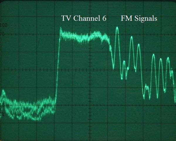

One thing I was trying was to focus south on WRME, but even though the WRME coverage map shows me in range, it won't come in at all. I found that interesting..
WRME is on real channel 6, which is a VHF-Low channel. What antenna were you using, the MCM 30-2476 or the Radio Shack VU-210XR?
Also, if you are using an FM filter, it might be taking out part of channel 6.

I can't receive WRME via TV either, but I get 87.7 FM fairly well, w/ a double folded dipole.
Old 22-May-2016, 10:06 PM   #11
I think that's all you are going to get because it is an FM station on a channel 6 TV frequency.

In order to see latitude and longitude as well as draw directional lines on a google map I use the web site heywhatsthat.com. Click on new panorama and enter your address. The Lat and long will be displayed below the map.
