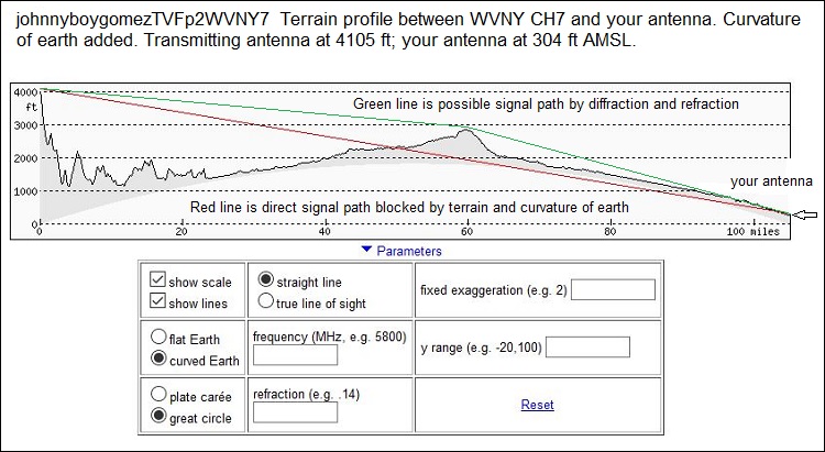

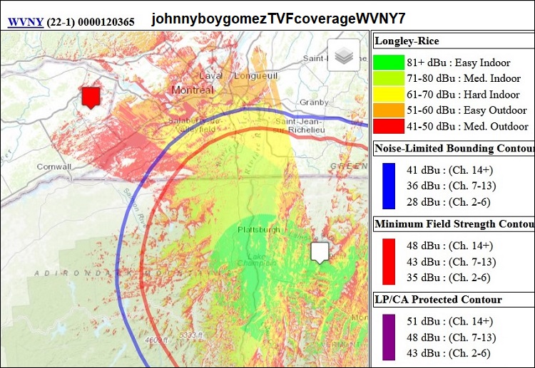

Second. For WVNY. It is on VHF channel 7. Do you think that making a custom cut antenna optimized for 177mhz would be worth it? I have found the required specs at https://www.changpuak.ch/electronics...enna_DL6WU.php
WVNY has a very difficult signal path to your location:
and your location is well out of the WVNY coverage area:
You can try making a custom Yagi for channel 7 or buy a Stellar Labs 30-2476 VHF-High Yagi when it again becomes available:
All the Mount Mansfield VT stations are similarly difficult path for you, and right on the digital cliff it seems. A custom yagi for RF 7 might be worth a try. I once built one for RF-21 (IIRC) before the last repack. About 8 feet long, of K7MEM's design. It worked a bit better than a 91XG, maybe 1-2 dB. But it helped me learn that the bigger swinger is location location location.
