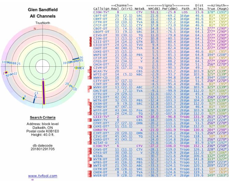

If you look at your TVFool report, you will see a red "c" next to the WVNY callsign. This is because WVNY has co-channel interference from CJOH-DT also on 13, unless it has moved. WVNY will move to real CH 7 because of UHF Repack by the FCC. WVNY must be at least 15 dB stronger than CJOH-DT to be received.

It appears that WPTZ shares channel 14 with CIII. WPTZ will remain on channel 14 during the repack. In order to eliminate the interference would would need to create a null toward CIII. One way to do this would be to stack a pair of identical antennas such as the 43XG horizontally spaced precisely 26” apart. Feed them with identical lengths of coax to a two way splitter.

WPTZ and WVNY both have co-channel interference which is probably why reception is poor. That said, WCAX is actually on RF-22 presently (switching to RF-20 after the repack) and yet you claim to receive it well, even though it has co-channel with CHCH. But the directions to the transmitters come into play as well. I'd be surprised if it is co-channel interference since the offending channels are almost 180 degrees away. That's interesting.
More likely is that Mt Mansfield signals are 2-edge and over 100 miles away so hot-spots and cold-spots are probably abounding at your locale. I get the Mt Mansfield stations from 72 miles in the other direction and had to work very hard to find a hot spot that worked for all five of the American stations.

Yes. WCAX does have adjacent channel interference from CBFT and CBMT on 19 and 21, but they aren't quite strong enough to knock out WCAX. They would have to be more than 33 dB stronger than WCAX to interfere with WCAX.
CJMT-DT is also on channel 20 with WCAX, but it doesn't seem strong enough to cause co-channel interference with WCAX.

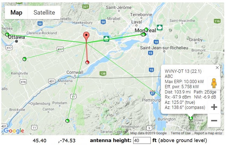

WVNY has a very difficult signal path to your location:
http://forum.tvfool.com/attachment.p...5&d=1602789033
and your location is well out of the WVNY coverage area:
http://forum.tvfool.com/attachment.p...6&d=1602789085
