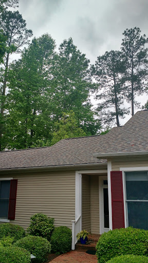

Hi guys, I'd really appreciate your thoughts on an antenna. I'd like to mount this on the roof of my one story suburban, North Carolina ranch. I live in a wooded area of pine trees. Its a concern but the trees aren't super dense. I've included a picture which is pretty much representative.

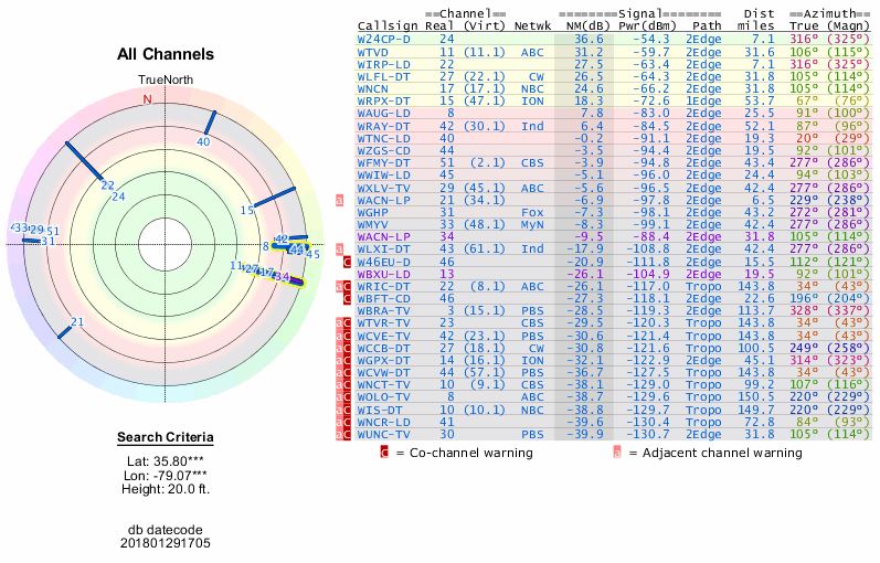

Here's my radar plot.
I'd love to be able to pick up both CBS and Fox. They're both about 43 miles away, And ABC, CW, NBC are about 33 miles and 180 degrees from the first two. And anything else would be a bonus.

For your tv Fool report what did you put in for an ANTENNA?

For the height, I put in 20 ft (low house). Is that what you mean?

Trees wiil block TV signals, but it is difficult to predict how much.
TVFool is using a defective database, so there are some errors in your report:

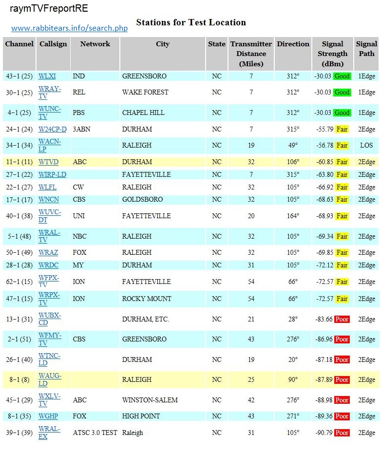

The list of channels from a rabbitears.info report is probably more accurate, but there are many changes going on because of UHF Repack by the FCC which will limit UHF to 14-36.
WTVD will be moving to real VHF High channel 9
https://www.rabbitears.info/market.p...&callsign=WTVD
WNCN will be moving from UHF channel 17 to VHF-High channel 8
https://www.rabbitears.info/market.p...&callsign=WNCN
WRAL from 48 to 17
https://www.rabbitears.info/market.p...&callsign=WRAL
and WRAZ from 49 to 15
https://www.rabbitears.info/market.p...&callsign=WRAZ
It looks like they will be in the same direction. You will need a UHF/VHF combo antenna like the Winegard HD7694P or 7698P. You might need a preamp, but try it first without.
