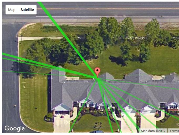

A few years ago this site helped me cut the cable. I started with an indoor leaf and gradually went to attic and an upgrade antenna on the roof.
I am moving into a one story townhome which formerly had a DirectTV subscription and the dish is still there. I want to replace that dish with a OTA suitable to my new location. As there is an HOA rule the antenna must be on the backside below the roof line I cannot raise it up above the current 20-25 ft location.
http://www.tvfool.com/?option=com_wr...e6a4ee500a804d
The current dish is on the northside of the townhome. I have 3 TVs and think we can hook the antenna into the coax that feeds the tv hook ups. In my previous town location an amplifier was not recommended.
I would like to get the stations in the green and yellow bands, that should not be an issue to those to the north west but not sure about the ones to the south over the ridge of the roofline. Advice appreciated about an omni direction antenna and amplification and splitter booster. I am 68 and will get some help from my daughter's boyfriend to do the roof climbing but I wanted to do all the homework and buy the parts.

Your plot shows stations both to the southeast and the northwest. Assuming that you have good line of sight to the distance in both directions (meaning no buildings or mountains in the way) I'd recommend the Antennas Direct Clearstream 2-Max. It is a bi-directional antenna and, if aimed at roughly 322 degrees using a compass, would get you most of the stations from both Buffalo and Toronto/Hamilton.

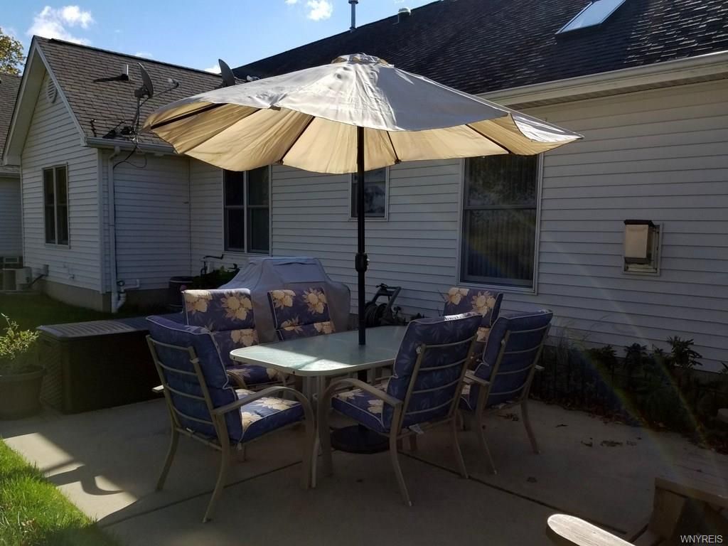

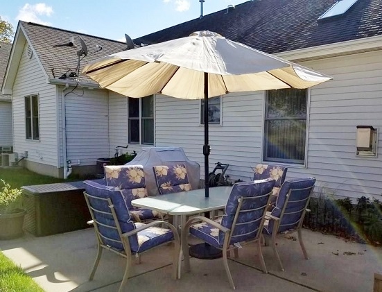

Attached is a photo of the back of the unit with my unit's dish and the neighbors over the top of the umbrella. An antenna pole to elevate to the roof line is going to be noticeable and I am concerned about HOA displeasure even if FCC says I can make that change and it is within the boundaries of my unit.

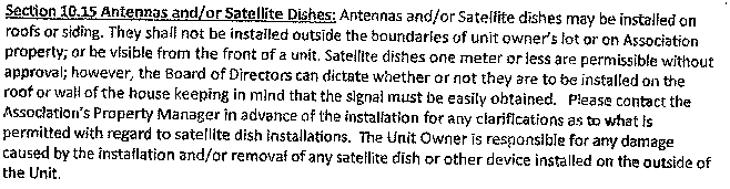

ADTech - On Grand Island city planners do not allow for condos. The rules for Townhomes are that I own the unit and the land it is on. However the HOA and the management company hired to maintain the property have defined rules that limit the homeowner when it comes to external changes to our units. I intend to fight them about changing my sidewalk to a no barrier slope which disrupts their uniformity of landscape rules. For now I plan to get some temporary ramps to assist wheelchair entry for guests. I digress.
Per antenna rule attached

Rule did not attach to the last post.

Thank you for the photo showing the dish; it helps.
You have two problems with the HOA, both of which are in a gray area. Their antenna restriction is poorly written. The one meter limit is for a dish. OTA antennas are allowed to be larger, according to the FCC. IF you own the roof and the land, you are allowed to have your antenna at any location needed for good reception, as long as it isn't any higher than 12 feet above the peak of your roof. What is critical is the form of ownership as defined in your contract.

The main problems are that your signals are in two directions, and there is a great difference in signal strength. There are ways to solve the two direction problem; in your case it is with a bi-directional antenna.
The signals from the NW are much stronger than the signals from the SE, but the roof blocks the signals from the SE, making the difference even greater.

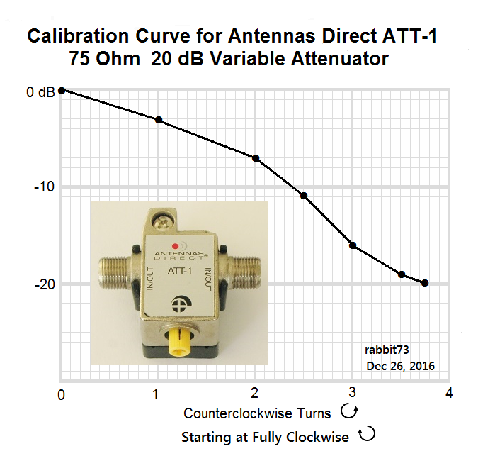

I suggest you first try the ClearStream 2MAX™ in the dish location. You might need to insert an attenuator to make the signals weaker to prevent overload. It would need to be enough attenuationt to keep the NW signals from causing overload without making the SE signals too weak. The coax should be grounded with a grounding block for the attenuator to be effective. Otherwise, the strong signals could get directly into the TV. The Dish guys should have grounded the coax.
https://www.antennasdirect.com/cmss_...es/ATT1_QS.pdf
http://www.solidsignal.com/pview.asp?p=att-1
If more than 20 dB of attenuation is needed, you can add a fixed attenuator of 10 or 20 dB:

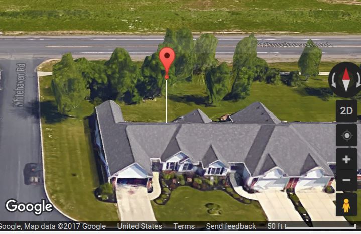

The trees on the North side might actually help.

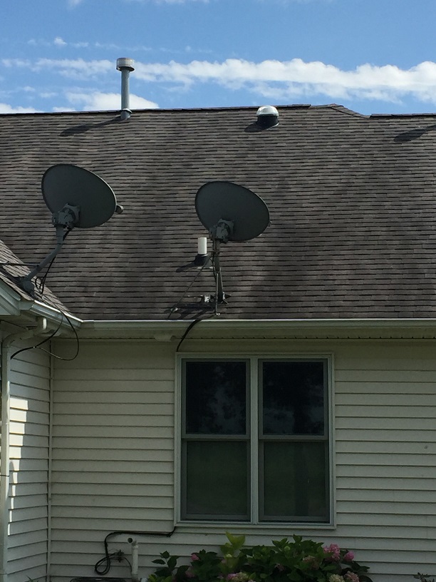

Wow, Rabbit73! Thank you for your clear and concise instructions. I have not peaked into the attic crawl space but it would solve the visibility issue and allow the antenna to be in the peak of the roof.
I will pick up the antenna with the reflector in case we need it. I took a couple new photos of the roof while running a load over today. As noted right now beyond those young trees there is open field and a golf course to the north. There will be houses being built across Whitehaven in the next several years which may impact me once they are in place. I can hope that the gaps in the houses will thread the needle for my directional settings.
Are there extenders for the dish pole that would allow me to get it a bit higher but still unobtrusive to the current roof line? Also since the signal strength is so strong on 3 main channels I understand amplification is counter productive. What about boosting split between TVs?
Since the mount has braces, it could probably handle a 5 ft extension. Anything longer would be pushing it. The trick would be to match the diameters. If you are allowed to go higher, you would need a different mounting arrangement.
