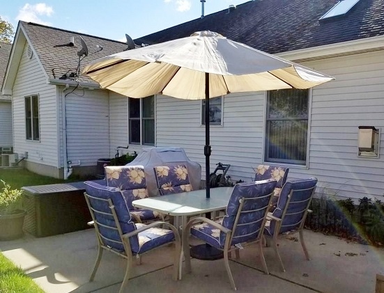

Attached is a photo of the back of the unit with my unit's dish and the neighbors over the top of the umbrella. An antenna pole to elevate to the roof line is going to be noticeable and I am concerned about HOA displeasure even if FCC says I can make that change and it is within the boundaries of my unit.

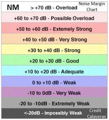

The Marathon and the 1byone are not suitable for you, because the amplifier that they have will be overloaded by your unusually strong signals. If you look at your report, you will see that the first three channels have the signal power (dBm) highlighted in red, which is an overload warning.
http://www.tvfool.com/?option=com_wr...e6a4ee500a804d
Another way to define overload is by the Noise Margin number in the report.
http://forum.tvfool.com/attachment.p...6&d=1471824123
Thank you for the photo showing the dish; it helps.
http://forum.tvfool.com/attachment.p...1&d=1501183717
You have two problems with the HOA, both of which are in a gray area. Their antenna restriction is poorly written. The one meter limit is for a dish. OTA antennas are allowed to be larger, according to the FCC. IF you own the roof and the land, you are allowed to have your antenna at any location needed for good reception, as long as it isn't any higher than 12 feet above the peak of your roof. What is critical is the form of ownership as defined in your contract.

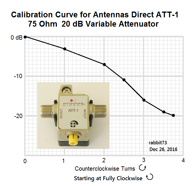

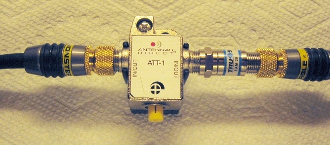

I suggest you first try the ClearStream 2MAX™ in the dish location. You might need to insert an attenuator to make the signals weaker to prevent overload. It would need to be enough attenuationt to keep the NW signals from causing overload without making the SE signals too weak. The coax should be grounded with a grounding block for the attenuator to be effective. Otherwise, the strong signals could get directly into the TV. The Dish guys should have grounded the coax.
https://www.antennasdirect.com/cmss_...es/ATT1_QS.pdf
http://www.solidsignal.com/pview.asp?p=att-1
http://forum.tvfool.com/attachment.p...1&d=1501197384
If more than 20 dB of attenuation is needed, you can add a fixed attenuator of 10 or 20 dB:
