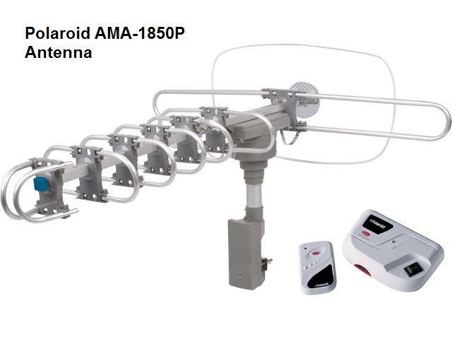

I have one of those cheap, motorized 150 mile antennas with a rotor.
I plan to try it on the side of the house and eliminate the DB8e just to see if it works or improves anything.
It won't be as high as the DB8e.
Once again, thank you for any suggestions and patience
It is a Polaroid AMA-1850P

My mini experiment with the motorized cheapy.
It's standing about 6'
Manually adjusting without the rotor I got RF 51, RF 38, RF 43 and RF 25 as well as 32? Virtual 6 from Johnstown
Those weren't very fine adjustments that I could make with the rotor.
Not sure what this is telling me.

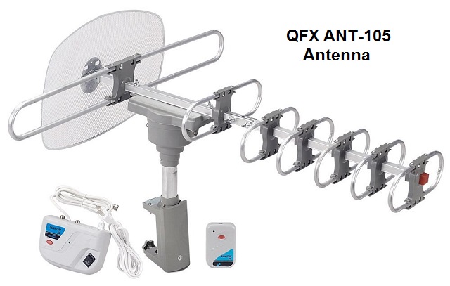

Your Polaroid antenna has a built-in preamp. It is telling you that your Channel Master antenna needs a preamp up near the antenna.
The photo of the Polaroid antenna shows the front director folded forward, which is odd. And the reflector at the rear is unusual; I can't tell what it is made out of.
The similar QFX antenna has the front director folded back like the rest of the directors.

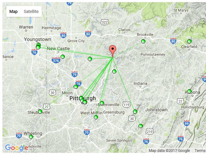

Old 2-Dec-2017, 3:09 AM   #54
The 6 channels:
WTAE ABC, real channel 51, NM @ 20 ft 9.0 dB, 196 deg
WPXI NBC, 48, NM 15.1 dB, 216 deg
WPGH Fox, 43, NM 17.3 dB 218 deg
WPNT MyN/Comet, 42, NM 7.4 dB, 218 deg
WINP ION, 38, NM 9.6 dB, 212 deg
KDKA CBS, 25, NM 21.9 dB, 219 deg
I don't see any VHF channels, real channels 2-13, in that list.
WQED PBS is on real channel 13.

Old 2-Dec-2017, 3:31 PM   #60
Do you need Youngstown?
Your report at 20 feet for reference:
http://www.tvfool.com/?option=com_wr...e6a43501c0927d
at 30 feet:
http://www.tvfool.com/?option=com_wr...e6a472ea681a52
Originally Posted by blackstone View Post
Unfortunately, it would be for multiple TVs.
If you want all channels in all directions, that will be very complicated. Your signals are weak, which requires high gain antennas. High gain antennas have a very narrow beamwidth; that is the tradeoff with gain vs beamwidth. You also need a preamp for each antenna. Your system will require four antennas with three coax downleads. Each TV will require three coax connections and two separate tuners.
If that is not acceptable to you, then you will need to settle for fewer channels. A CATV system does it with multiple antennas, single channel amplifiers, and a combiner for all channels. It costs thousands of dollars and looks like this:
It would be a nice bonus if the Polaroid would pick up both WJAC (UHF) and WWCP (VHF)
but it doesn't seem to work on VHF.
The Polaroid will work on VHF, but only for very strong signals, because it has a single folded dipole for VHF. WJAC on UHF channel 34 is at 142 degrees, and WWCP on VHF channel 8 is at 158 degrees. You would need a UHF antenna and a VHF antenna combined with a UVSJ just for the SE.
