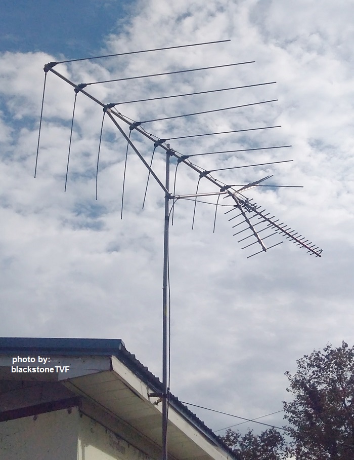

Can you tell us more about your current "25+ year old" analog antenna, and where is it aimed? What model is it, mounting height, field of view (any trees?) etc.

I'll see if I can get a picture of the present antenna.

(I have a picture but don't know how to add it)

Pic
https://photos.app.goo.gl/kHBpQBfFRdwSmn283
https://photos.google.com/photo/AF1Q...aiYaWTykhaeYpj
blackstone 12-Sep-2017 9:07 PM
That didn't work for the pic

rabbit73 12-Sep-2017 10:33 PM

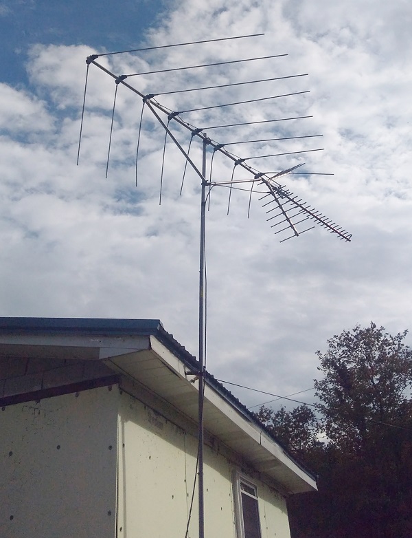

2 Attachment(s)
I got the first one to work, but not the second one.
You can click on the photo in your album for a share link like this one:
https://photos.google.com/share/AF1Q...xKMTY3RlRkVl93
You can also upload the photo as an attachment for your post, using Go Advanced, but it has to be smaller than 1024 x 1024. Your image is 1836 x 3264 pixels, so I edited it, gave you a credit line, uploaded it as an attachment, and then added it as an image to my post.
http://forum.tvfool.com/attachment.p...1&d=1505256907
This smaller image shows more of the tree in front of the antenna;
http://forum.tvfool.com/attachment.p...1&d=1505257968

That looks like a metal roof in your picture. I wonder if that affects reception. More height, which will get your farther away from the roof, probably can't hurt. My concern has to do with the age of the antenna, but more importantly the coax. I've heard that the coax performance can degrade over time, especially at connections. I would try switching to a high-quality RG-6 (you prabably have RG-59), and use new connections, perhaps before even trying a new antenna. When you do this, take some signal readings at the bottom of the down-lead first, then change the coax and re-do the readings to see if there is an improvement.

What direction is the antenna aimed in the photo?
blackstone 13-Sep-2017 6:03 PM
Guessing without a compass.
215-240.
