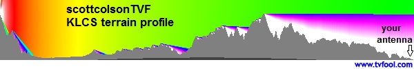

Your reception of that channel is consistent with Tropospheric Propagation enhancement, which is more common at this time of year. You are otherwise pretty much in a dead zone for KLCS because of terrain interference:
Well, at least we now know your antenna and preamp are working OK.
