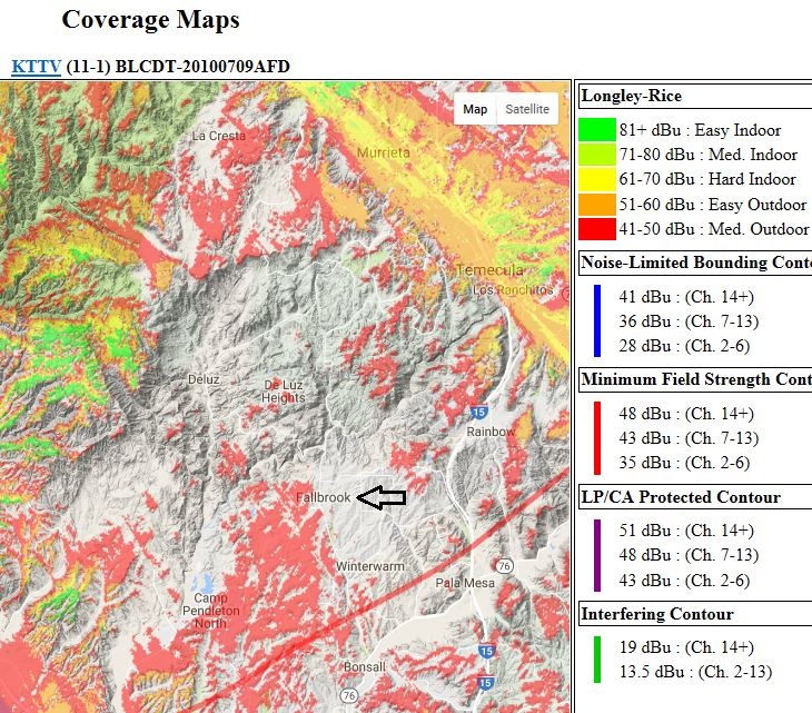

You are just inside the KTTV FCC Minimum Field Strength Contour. The coverage is very spotty because of the rough terrain:
http://forum.tvfool.com/attachment.p...1&d=1499477531
I think your location is just above the arrow where there is no color.
The link to the Longley-Rice coverage map for KTTV:
http://www.rabbitears.info/contour.p...=1423068&map=Y
