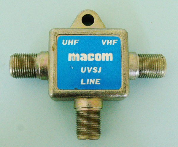

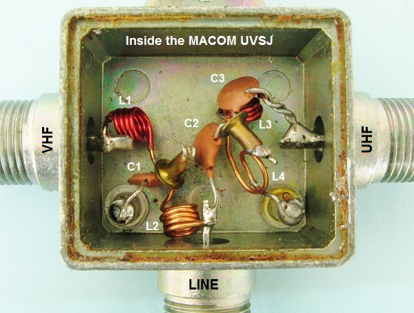

The MCM 33-2230 does have a higher insertion loss that might make a difference if your marginal signals are at the "Digital Cliff."
The Macom UVSJ has very low loss because it has fewer components.
L1, C1, and L2 are the lowpass VHF filter; C2, L4, C3, and L3 are the UHF highpass filter.
This UVSJ will pass power to a preamp for the VHF antenna through L1 and L2.

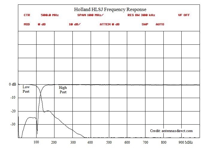

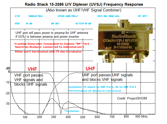

A HLSJ is not the same as a UVSJ. A UVSJ passes UHF and blocks VHF-High and VHF-Low on the high port; it passes VHF-High and VHF-Low on the low port. A HLSJ passes VHF-Low and blocks VHF-High and UHF on the low port; it passes VHF-High and UHF on the high port.
IOW, the crossover for a UVSJ is between VHF-High and UHF; the crossover for a HLSJ is between VHF-Low and VHF-High.

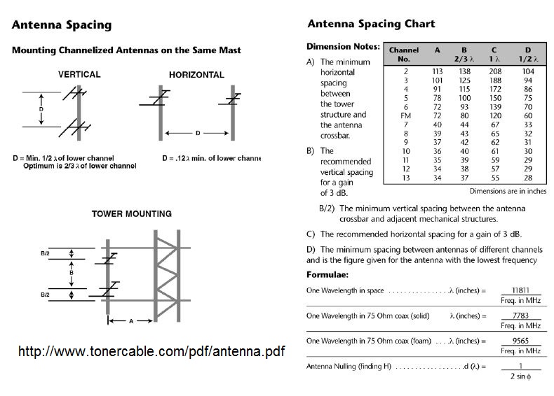

Question: What separation distance should I try (to start with) for vertical or horizontal stacking of two HDB91X antennas?

Even though an HLSJ is a different device than what was needed, it should have no ill effect on UHF pass-through provided the ports were not reversed. Only high-VHF should have been affected (assuming correct connection and no other defects).

Thanks for the info on spacing Rabbit. The chart is slightly confusing, but if I'm reading it right, it looks like the optimum vertical spacing is 0.67*lambda, and the optimum horizontal spacing is 1*lambda, where lambda is the wavelength of the "lower-channel antenna". Since my UHF antennas are obviously both the same, I guess I'll take that to mean the the lowest frequency in the UHF band (Ch14 = 473 MHz), so my lambda is 25-inches. The spacing to optimize reception of WFFF (Real Ch43 = 647 MHz) should be based on lambda=18".
At least those are some ball-park numbers to start with. I'll try vertical stacking first because it is easier to implement. I notice that 0.67*lambda for Ch14 is 16.5". That seems pretty close, but we'll see if it works. The recommended vertical spacing is even closer for Ch43 (0.67*lambda = 12.25").
It seems too close to me also.
This is how seeyabarney stacked his antennas:
his thread:
http://forum.tvfool.com/showthread.php?t=16301

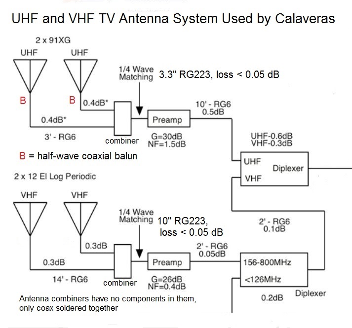

I'm worried that the combiner losses might be swamping any stacking gains. Can anyone recommend a ultra-low loss combiner I should try?
Most combiners are a splitter used in reverse as a combiner. The insertion loss is very low, average about 0.5 dB. So, the most you can gain by stacking is about 2.5 dB.
However, if the field is non-uniform and one antenna receives a weaker signal, then the gain from stacking can be much less. It's a difficult concept to grasp, but it is possible to end up with less gain from two stacked antennas than what you had with one, even if both antennas are identical, are aimed at the same azimuth, and have feedlines that are the same length.
http://www.hdtvprimer.com/ANTENNAS/merging.html
WFFF will be moving to channel 16, so you will want your antenna to have the highest gain at the low end of UHF, like the DB8E.
http://www.rabbitears.info/market.ph...&callsign=wfff
The only way I know of to combine with a lower loss is to connect both lines together in parallel, giving an impedance of 37.5 ohms, and add a 1/4 wave matching section of 50 ohm coax which transforms the 37.5 ohms to 75 ohms. It would be a custom job. This is what Calaveras did with his two 91XG antennas.
http://www.aa6g.org/DTV/index.html
http://www.aa6g.org/DTV/ABD/Antenna_Block_Diagram.html

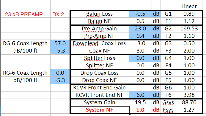

To summarize, these are the factors to consider when hunting for weak marginal signals:
1. Select an antenna that has the highest gain available for your most desired channel. In your case, it would probably be the AD DB8E after the move to Ch16:
2. Mount the antenna in the best hot spot you can find on your property. That might not be where you want it for the sake of appearance. Often, a single antenna up higher will out perform a stacked pair and will be easier to mount.
3. Keep the coax between the antenna and the preamp input short; every 16 feet of coax is like a 1 dB loss of antenna gain for UHF.
4. Consider switching to a low Noise Figure preamp like the KT-200. They can make the reception of weak signals easier, but are more sensitive to static damage; that's the trade-off.
This is the way it works:
The antenna gain must make the signal strong enough to exceed the Noise Figure of the preamp plus the 15 dB minimum required SNR for the signal. Once the signal reaches that point, the preamp will amplify the signal to overcome the distribution losses. The preamp will also amplify the Thermal Noise Floor which will bury the tuner Noise Figure, making it irrelevant.
The metric for the antenna system performance is called the System Noise Figure; the lower the number, the better. It is primarily determined by the preamp at the beginning of the chain. The System Noise Figure can be calculated using the Friis Noise formula.
https://en.wikipedia.org/wiki/Friis_formulas_for_noise
An important consequence of this formula is that the overall noise figure of a radio receiver is primarily established by the noise figure of its first amplifying stage. Subsequent stages have a diminishing effect on signal-to-noise ratio. For this reason, the first stage amplifier in a receiver is often called the low-noise amplifier (LNA).
System Noise Figure calculations for the above Noise Margin diagram:
reducing the balun loss and the preamp NF:

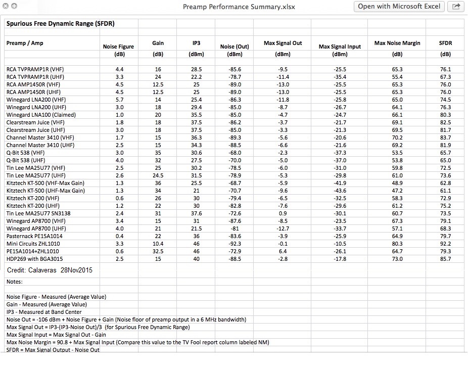

It looks to me like the KT-200 might be worth a try for my situation, especially since Research Comms is in the UK. Do you guys have experience with the KT-200s? Is the 0.4 dB NF legit?
Old 1-Jul-2017, 2:46 AM   #76
The NF is optimistic, but still quite good. That would be the one I would try. Get the coax powered outdoor enclosure version. I can't guarantee that it will improve your reception, but I think it's worth a try.
http://www.kitztech.com/KT200.html
http://www.kitztech.com/standard_coax.html
The LNA-200 isn't as good as when first released. They made some design changes to meet a price point that reduced the performance. Also the shielding isn't adequate. It uses 5V which isn't so good with long coax runs because of the voltage drop. CM made the same mistake with the CM7777hd Amplify preamp.
http://www.highdefforum.com/local-hd...er-7777hd.html
Calaveras on AVS tested a whole bunch. His results in the attachment.
