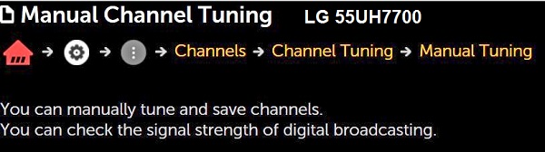

Old 3-Jun-2017, 6:06 PM   #6
Settings > Channels > Manual Tuning
You can manually tune and save channels.
You can check the signal strength of digital broadcasting.
from User Guide zip file:
http://www.lg.com/us/support-product/lg-55UH7700#
also in User Guide HTML file under Tour List of Settings

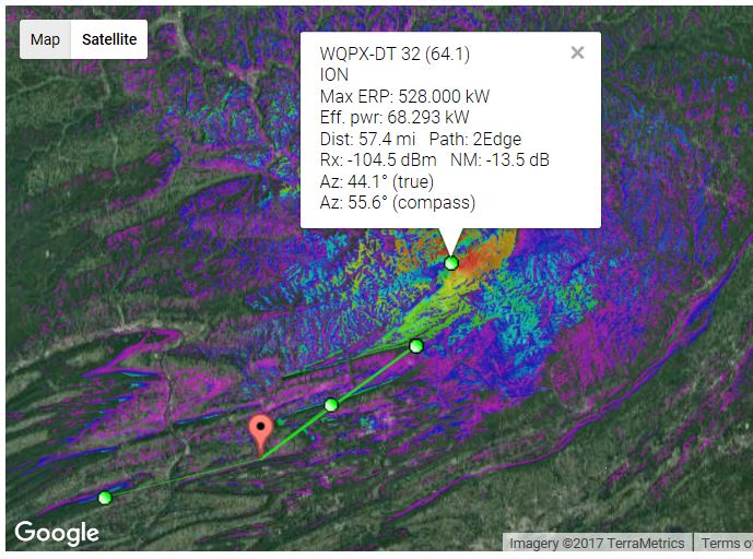

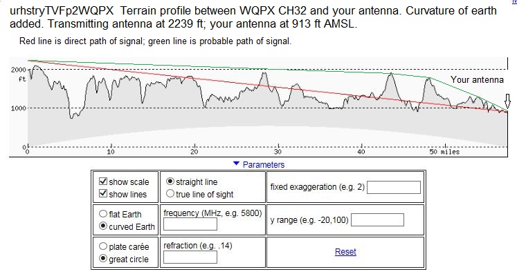

Old 4-Jun-2017, 7:44 PM   #16
If you click on the WQPX callsign in your report you will see the terrain profile between the WQPX transmitter and your location on the right:
http://www.tvfool.com/?option=com_wr...dALLTV%26n%3d9
You can see there isn't much signal left when it reaches your antenna. Also, there is only 68 kW ERP left out of 528 kW ERP because of the directional antenna used by WQPX.
Here is another profile done with other software:

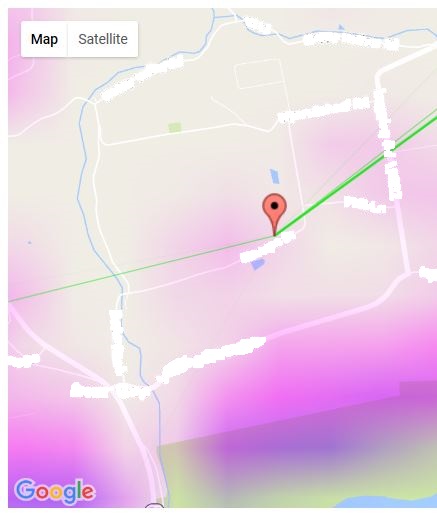

Old 4-Jun-2017, 8:04 PM   #17
Here is a coverage map for WQPX. You are on the extreme fringe:
I'm not certain where your property line is, but it looks like you might pick up one dB if the antenna is just east of the house instead of on the west side in the small plowed area.
Other things to consider are an antenna with more gain and a preamp with a lower noise figure.
If you go to separate antennas for UHF and VHF, it sometimes helps to tilt the front end of the UHF antenna up to catch the signals coming down from the mountain peak.
