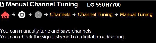

rabbit73 3-Jun-2017 7:06 PM
1 Attachment(s)
Settings > Channels > Manual Tuning
You can manually tune and save channels.
You can check the signal strength of digital broadcasting.
http://forum.tvfool.com/attachment.p...1&d=1496514237
from User Guide zip file:
http://www.lg.com/us/support-product/lg-55UH7700#
also in User Guide HTML file under Tour List of Settings

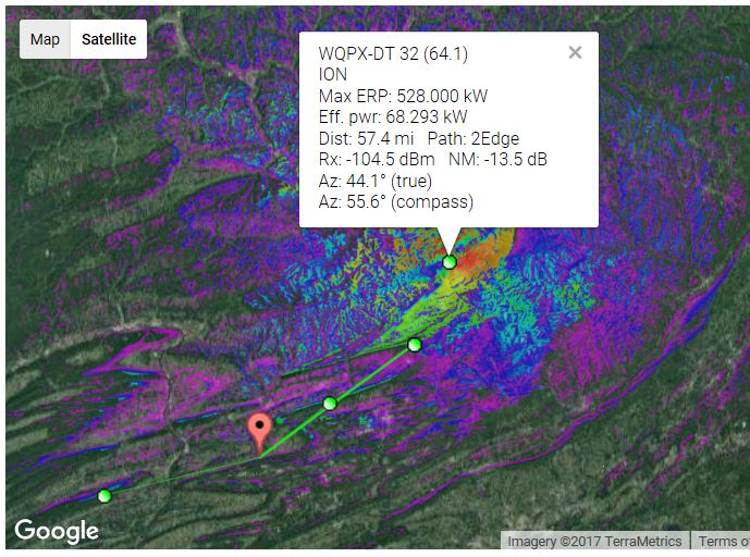

rabbit73 3-Jun-2017 9:17 PM
1 Attachment(s)
I want to make sure I am not overdriving the tuner with my inline amp.
Since you didn't give us a tvfool report, I had to make an estimate of your location to give a better answer.
http://forum.tvfool.com/attachment.p...1&d=1496520993
Your signals are quite weak and 2Edge (interference from terrain). You will need a high gain antenna for UHF and VHF-High aimed at 60 degrees magnetic.
You should use a preamp at the antenna. If you have more than one TV, try a passive splitter before adding a distribution amp.
WQPX is the weakest signal you will be able to receive, except when there is signal enhancement from Tropospheric Propagation

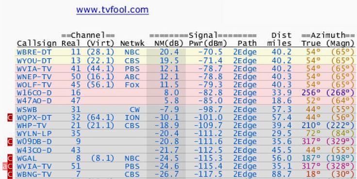

urhstry 4-Jun-2017 1:58 AM
Here is my link...
http://www.tvfool.com/?option=com_wr...e6a427afdb8385
I have a CM5018 and a CM-7777 Amp. I can NOT get channel 64 which is 8 channels (64-1 to 64-8) that I really wish I had. Thanks for the manual tuning help.... I'm going to try that now.

rabbit73 4-Jun-2017 8:25 PM
Originally Posted by urhstry (Post 58102)
Here is my link...
Thanks for the tvfool link. Very close to my estimate.
Which 7777 do you have; the old one with two antenna inputs, or the new one with only one antenna input? Where is the antenna located on your property? Where is the 7777 located? How long is the coax from the preamp to your power inserter and TV?
WQPX is your weakest possible signal. It is difficult to receive any signals with a NM of less than -10 dB. If you do receive a signal that has a NM of less than -10 dB, you have an excellent antenna system, your tvfool report is wrong, or they have been enhanced by Tropospheric Propagation.
http://forum.tvfool.com/attachment.p...9&d=1453496093
This is the way it works: You must have enough antenna gain to give at least the minimum required SNR of 15 dB plus enough gain to offset the NF of the preamp. Once there is enough signal for the preamp, it will amplify the signal and the noise to overcome distribution losses and bury the noise figure of the tuner in the amplified thermal noise floor.

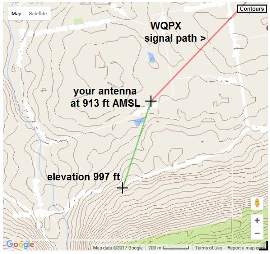

I tried different antenna heights using the tvfool interactive map browser:
WQPX Noise Margin
10 ft, -10.8 dB NM
25 ft, -13.5 dB
40 ft, -13.5 dB
50 ft, -13.3 dB
75 ft, -12.4 dB
100 ft, -11.9 dB
150 ft, -11.0 dB
200 ft, -8.9 dB
250 ft, -6.8 dB
300 ft, -4.5 dB
350 ft, -2.3 dB
400 ft, -0.2 dB
450 ft, +1.7 dB
500 ft, +3.7 dB, but still 2Edge because of terrain interference
What is interesting is the better NM at 10 ft which is the default height I used in the report I did. The better number at 10 feet than at 40 feet is probably because of signal enhancement from ground reflection; I've seen it before.
You would have to go pretty high for a big improvement in NM and I don't see a lot of higher areas on your property.
That just leaves tweaks to your antenna system.

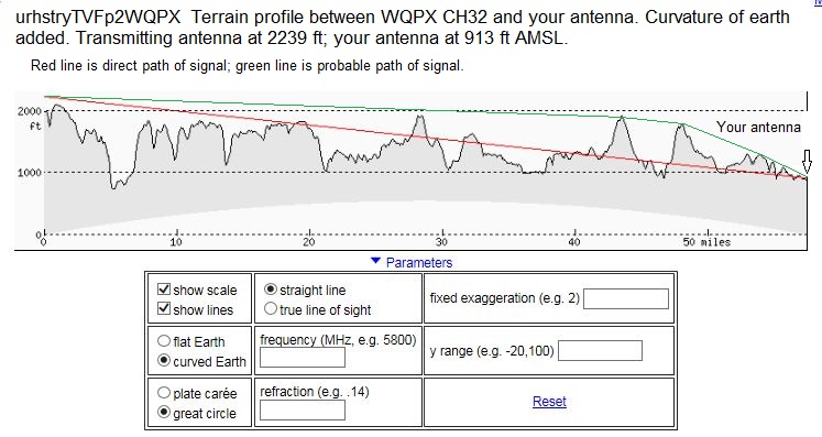

rabbit73 4-Jun-2017 8:44 PM
2 Attachment(s)
If you click on the WQPX callsign in your report you will see the terrain profile between the WQPX transmitter and your location on the right:
http://www.tvfool.com/?option=com_wr...dALLTV%26n%3d9
You can see there isn't much signal left when it reaches your antenna. Also, there is only 68 kW ERP left out of 528 kW ERP because of the directional antenna used by WQPX.
Here is another profile done with other software:
http://forum.tvfool.com/attachment.p...1&d=1496605721
and a contour map:

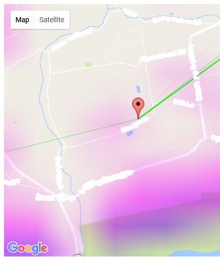

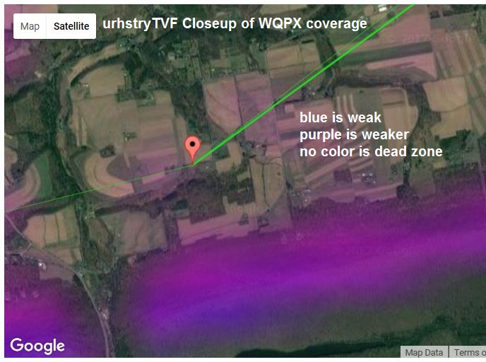

rabbit73 4-Jun-2017 9:04 PM
3 Attachment(s)
Here is a coverage map for WQPX. You are on the extreme fringe:
http://forum.tvfool.com/attachment.p...1&d=1496606445
http://forum.tvfool.com/attachment.p...1&d=1496606675
I'm not certain where your property line is, but it looks like you might pick up one dB if the antenna is just east of the house instead of on the west side in the small plowed area.
Other things to consider are an antenna with more gain and a preamp with a lower noise figure.
If you go to separate antennas for UHF and VHF, it sometimes helps to tilt the front end of the UHF antenna up to catch the signals coming down from the mountain peak.
